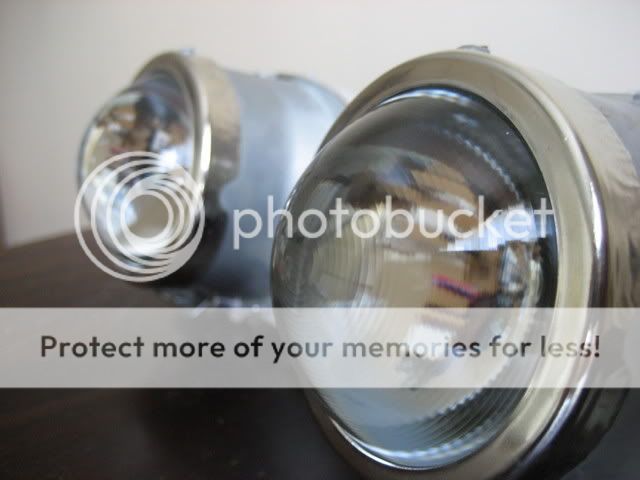

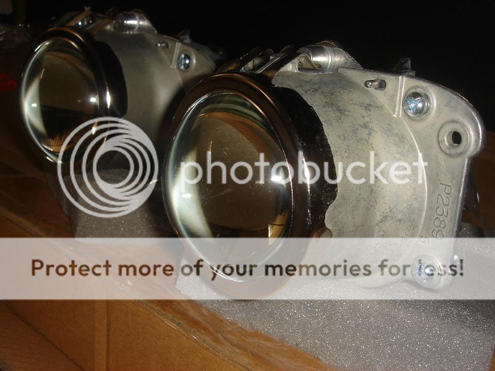

Clear:
Fresnel

Thanks for the pics. Are the clear ones in the pics yours and possibly for sale?
Old Mar 13, 2008 | 03:11 PM
striker_18's Avatar
Joined: Dec 2007
Posts: 370
Default Re: (kp99)
that's from a year ago but some people need comparison pictures so i just saved them on my photobucket account LOL

frsnel lenses can also be ade much thinner than a regular convex lens, but based on that picture they both look about the same depth.
