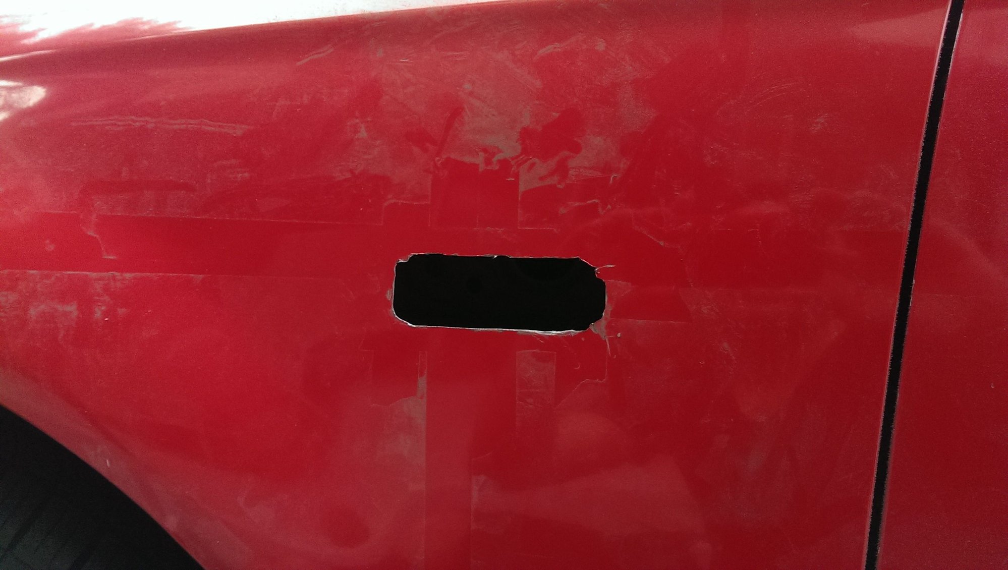

Just installed the sidemarkers on my car. Lemme know what you guys think.
Bought a rotary tool from Radioshack for only 22 bucks. Was on sale so I was like why not?
Marked off the sides according to the guide.
Made the first two cuts. Regardless of the rotary tool I had, the discs would run out really fast. So i went though about 8 of them on each side.
It's out!
Stripped the new wires and added the easy clip on couplers.
Did the wires for the side markers. I made them longer and folded them over to make the fitment into the coupler tighter.
I connected the couplers prior to putting them through the hole. This way wiring is much easier.
Snapped it in. I didn't have touch up paint, but i'll get that tomorrow.

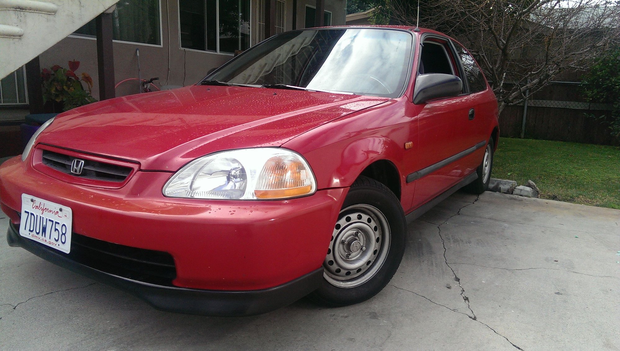

How it looks with the lights on daytime.
And the other side.
Finished product.
