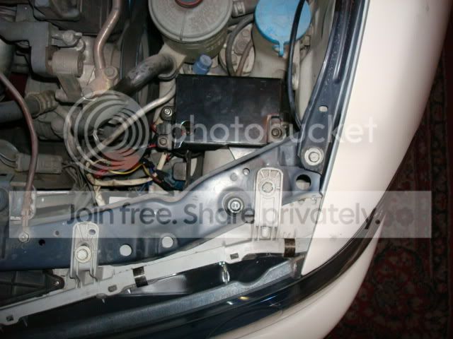

sup well i just installed my jdm hid headlights today. i checked out the cutoff line and to me it looks horrible, i used a philip screwdriver to try bring the projector up and down to line it up but i have no idea what should i do? Also the passengers side looks a little yellower than the drivers what could be the problem and how can i fix both of these problems. any help would be great thanks
i dont like how its crisscrossing it shouldnt be like this correct?

The rotation of the Drivers side headlight is off. I dont know how that is possbile because it's not a retrofit, but looks like you are going to have to pull the headlight apart and check it out.

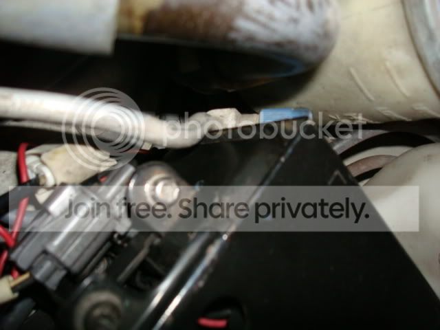

could it be because the ac lines is pushing it out and not letting it seat correctly?

Easy way to test is to turn on the lights while facing a wall and then apply pressure against the AC line away from the light and see if it's changes...
