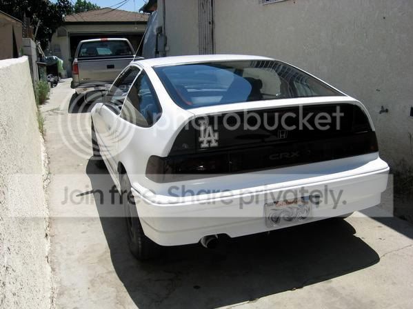

well the way i did the lights on my crx is first: you have to wet sandur tail lights to have a clean surface to spray the paint on..obviously you let them dry..and you have to mix black paint with clear coat and alittle hardener...it depends on how dark you want your lights which determines the amount of black paint you put in the mix..
you should spray it on a a different surface to get the right shade your looking for..
THIS IS HOW MINE TURNED OUT...
