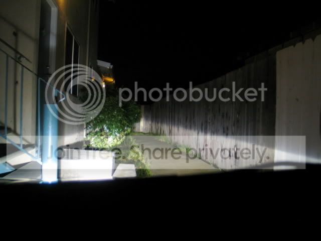

I had the philips 4300 plug and play kit in my integra a while back. I was very impressed with the light out put and the cut off, but there was still a slight glare. I ended up doing a retrofit and with the projectors I went with (cadillac cts projectors), it wasn't a huge upgrade. The only thing that was eliminated was the slight glare.......here's what my old plug and play looked like.
Haven't taken a pic with the retrofits yet.

clean can't wait to see the retrofit

x2 can't wait to see the "after" pic
