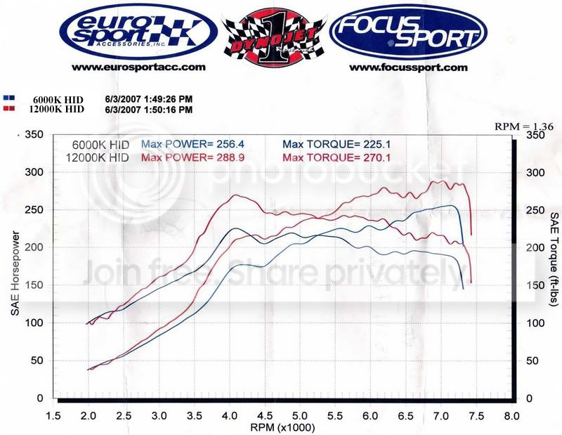

use whatever you can afford at the moment.
Oh yeah, HIDz increases horsepower!! The bluer the HIDz are, the more horsepower you will get!!
Here's a dyno to prove it:
Okay aside from all sarcasm, what you want is a proper HID setup.
A retrofit would yield some good results no doubt
