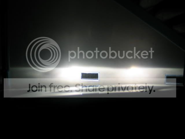

4300K in an HID projector retrofit! The ONLY good way of converting to HID.
Low beams:
Bi-xenon high beams + stock halogen high beams:
Check the lighting forum for more info, or visit http://www.hidplanet.com
Low beams:

My old 4300K kit:
next to my buddy's S2000:
HUGE difference in light output, beam pattern, beam width, sharpness, etc.
Integra projectors put most of the light 20-30 ft in front of the car, where it's pretty much useless, and the beam pattern is pretty narrow.
moral: PnP kits are junk compared to an HID projector retrofit.
