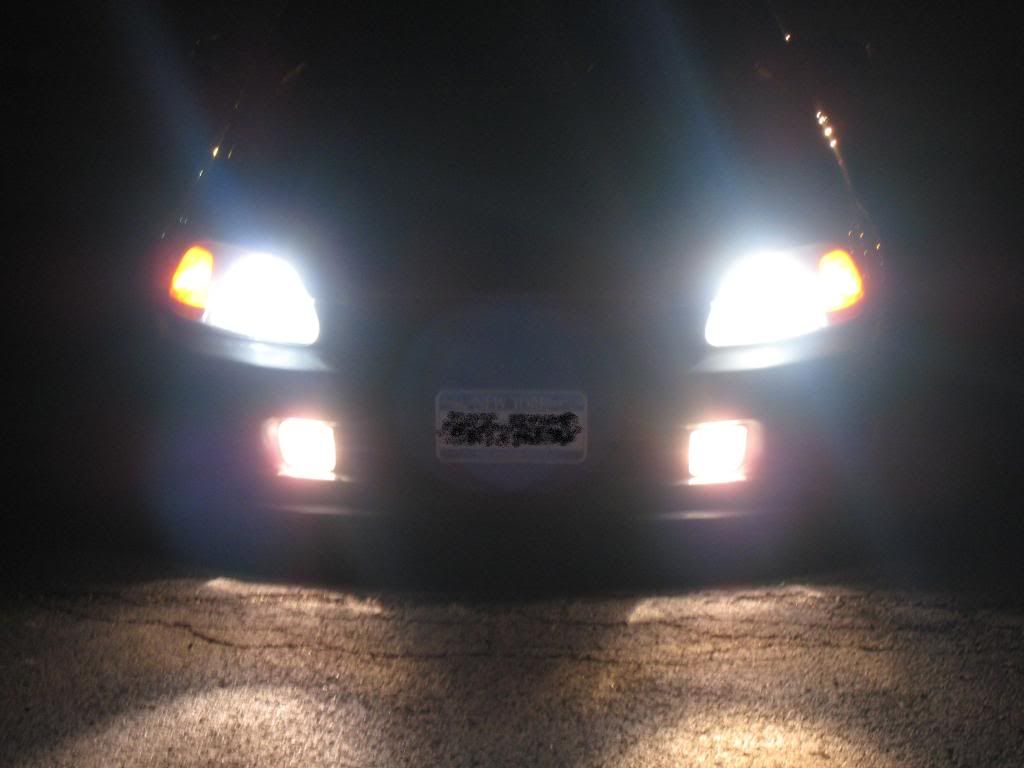

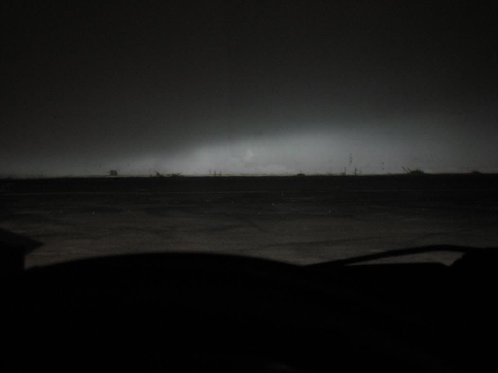

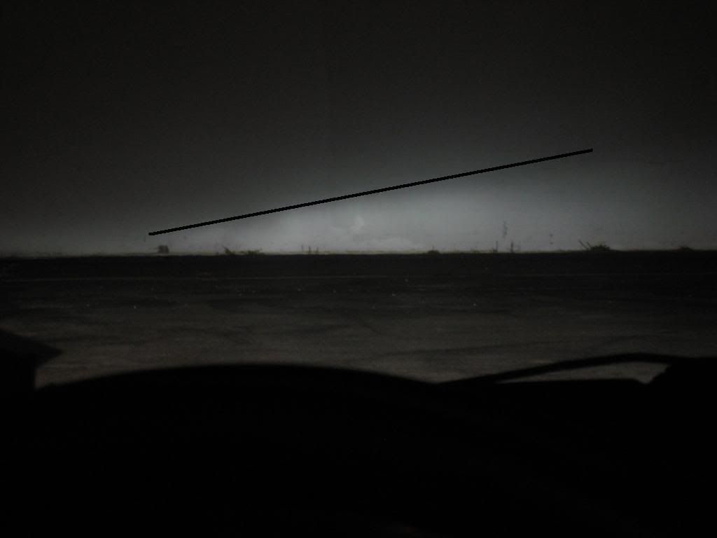

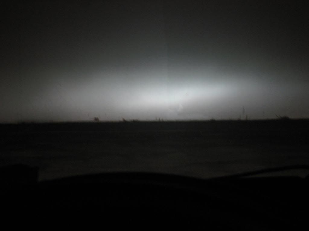

Old Feb 26, 2009 | 04:03 PM
brutekiller787's Avatar
Joined: Dec 2008
Posts: 466
Default Re: HID Kit question
Lows
lows with fogs for comparison
from outside the drivers side door
from on the ground against the wall
cut off from inside the car
highs
highs from the wall
no projector
Old Feb 26, 2009 | 06:37 PM
tilegend's Avatar
Posts: 246
From: NY, US
you call that a cutoff? i call that a hot spot.....
Old Feb 26, 2009 | 07:16 PM
PatrickGSR94's Avatar
Community Builder
Community Influencer
Active Streak: 60 Days
Joined: Jan 2002
Posts: 30,199
Likes: 59
From: Nowhere and Everywhere
looks like garbage, nothing but glare all over the place. No offense to you, just calling it like I see it, and that will for sure blind the hell out of everyone and probably barely puts any more light on the ground where you need it than stock H4's do.

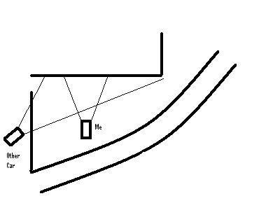

Old Feb 27, 2009 | 08:06 AM
Joined: Dec 2008
Posts: 466
I don't see how that's not a cut off line.
The "glare" is from another car's headlights that is parked in the gas station parking lot next to where i was doing this
they were parked with the headlights on the whole time. i even asked them if they could turn it off and they said no. typical ny douchebag
Old Feb 27, 2009 | 08:28 AM
nineohtoo's Avatar
Posts: 225
From: Nor Cal
That's not cut off dude. This is cut off:
Toshiba HIRs FTMFW! When I get better night pics in an empty lot I'll update to show how well these babies light up the road for miles.
