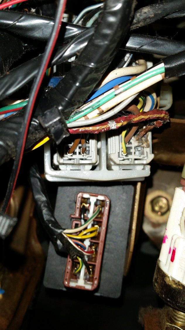

Ok, after some further research, and opening up under the dash, I found this...
That is the C301 connector, and it looks like it's the 12 Canada: RED/WHT (Headlights) pin. I didn't realize this was a Canada vehicle, but what can you do. Anyway, any recommendations on how to fix this?

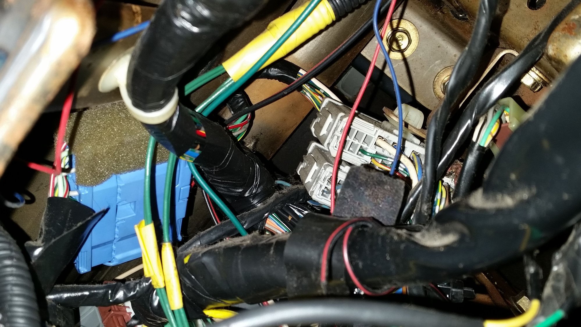

Ok, further explored, tracked it down into the C201 connector, the Red/Yel is burned out there as well... It almost looks like I would need a complete wiring overhaul. Ugh, any suggestions here?
