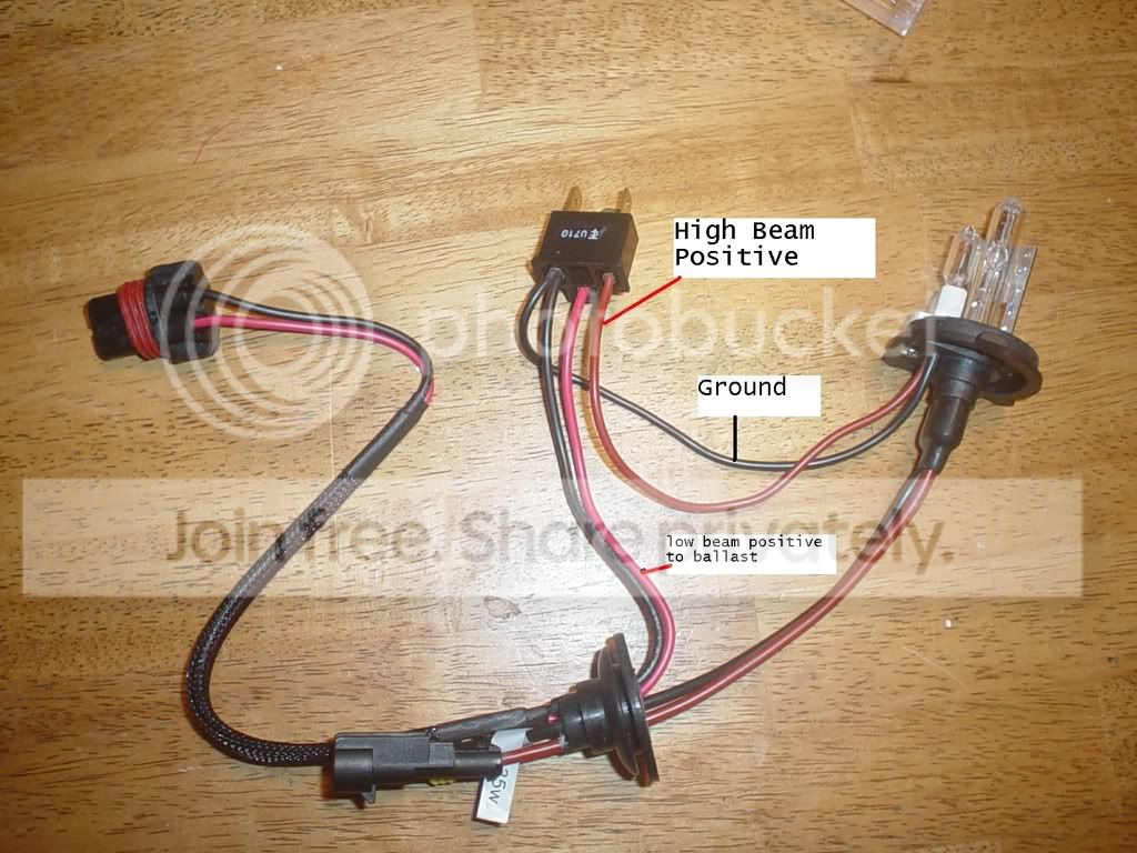

here is what you have and how it needs to be wired.
plug in the middle of the pic plugs into OEM headlight harness from car, plug to the left goes into the HID BALLAST. hid bulb on the right, halogen peanut bulb on the left.
