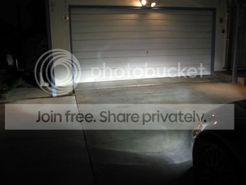

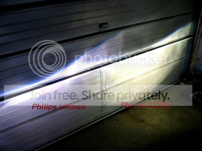

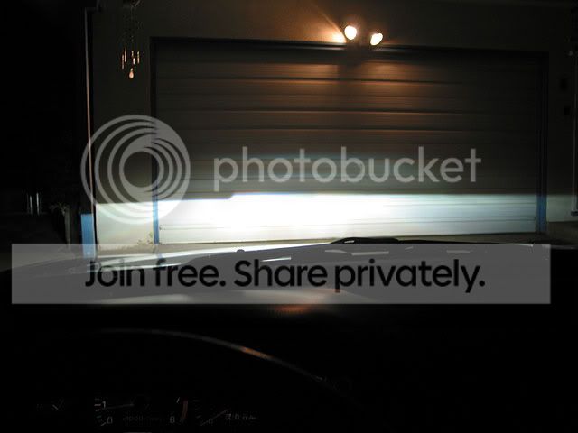

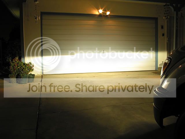

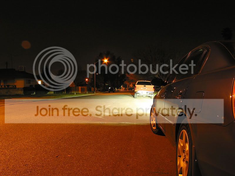

Here are two pics that compare your setup, the casper shields on hid bulbs vs. retrofit. I got these pictures from http://www.hidplanet.com, so these are borrowed from someone else's thread.
Casper shields
http://i214.photobucket.com/al...6.jpg
Retro fit
http://i214.photobucket.com/al...0.jpg
Notice the two pics are shot in the same location.
Pics borrowed from striker_1818 of http://www.hidplanet.com

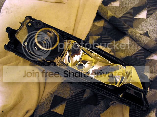

your best bet would definately be to spend the extra money and do a projector retro.. i did s2000 projectors on my 240sx like 4 years ago.. i posted pics on here a long time ago.. we also did RX330 projectors on my dads tacoma.. you cant come close to the quality of an OE HID projector..

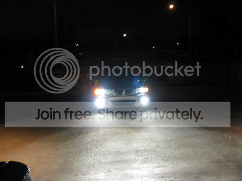

haha yeah im still around man.. ive kinda shifted my 100% interest these days from HID to detailing.. although i did put some 9006 4300K philips into the fogs on the m3

yeah mine are very visible.. they use 9006 bulbs.. its mostly a lot of foreground light though.. another thing i did was put brand new philips bulbs in my low beams to get rid of those crappy osram ones that came with the car.. WOW what a difference.. just puttng in the philips bulbs was night and day..
just fogs here

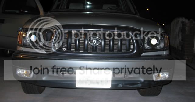

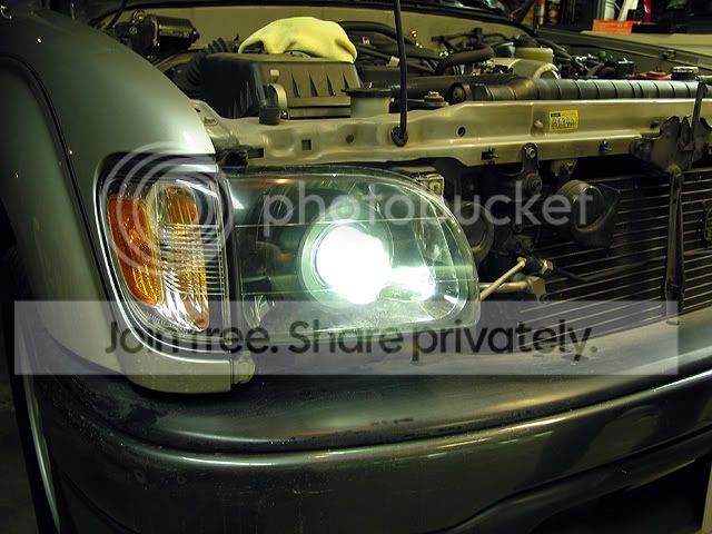

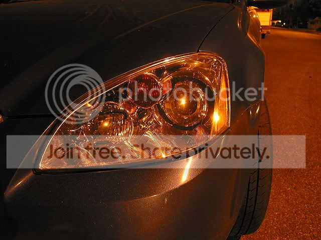

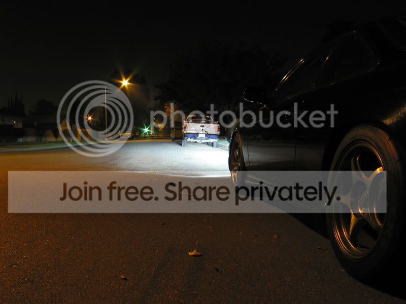

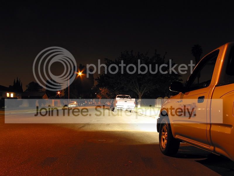

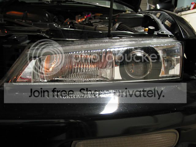

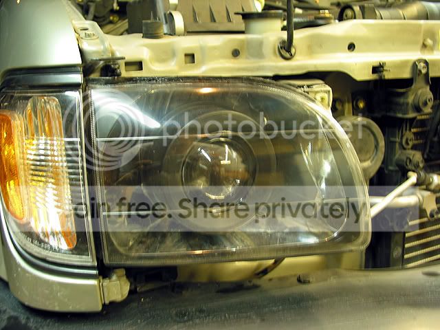

oh and to keep on topic.. here are a couple retros i did back in like 03/04
01 tacoma RX330 projectors.. some home depot plumbing things for bezels.

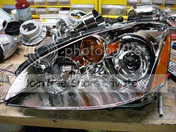

and my old 97 240SX w/ s2000 projectors

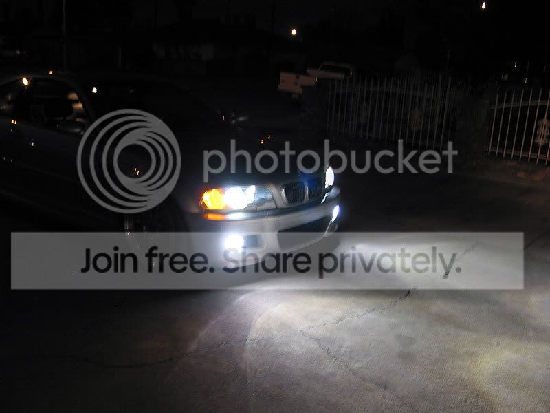

and this is one that the amazing larry from littodevil performance lighting did for my ex gf's altima.. s2000 projectors, audi a4 bezels.
and one of my favorite pics.. this proves 6000K = waste of money crap..
