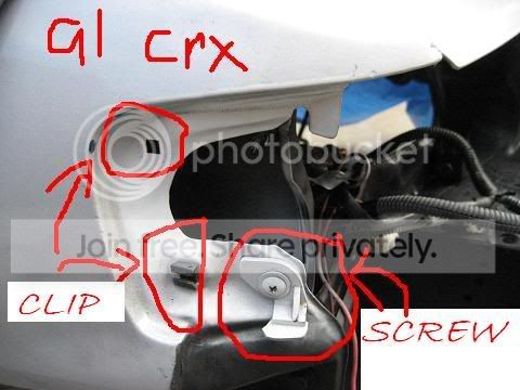

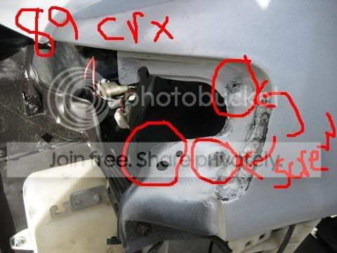

i got a 2 pics of whats the diffrence the 89 is like thiss
and the 91 is like thiss u can clearly see that there the same just cut the clips sides and make them flat and drill a hole threw them thats all u need to do to make them fit even all ef parts will work lots unless is out of a jdm whitch need some ajust ment

ps thats not my car lol ill take a pic of it installed on one side tomorow after work also u intrested in a 93 civic cluster with tach that will fit in ur ef to with some moding im trying to find a si cluster got a deal on one got to see how good it looks tho lol let me know
