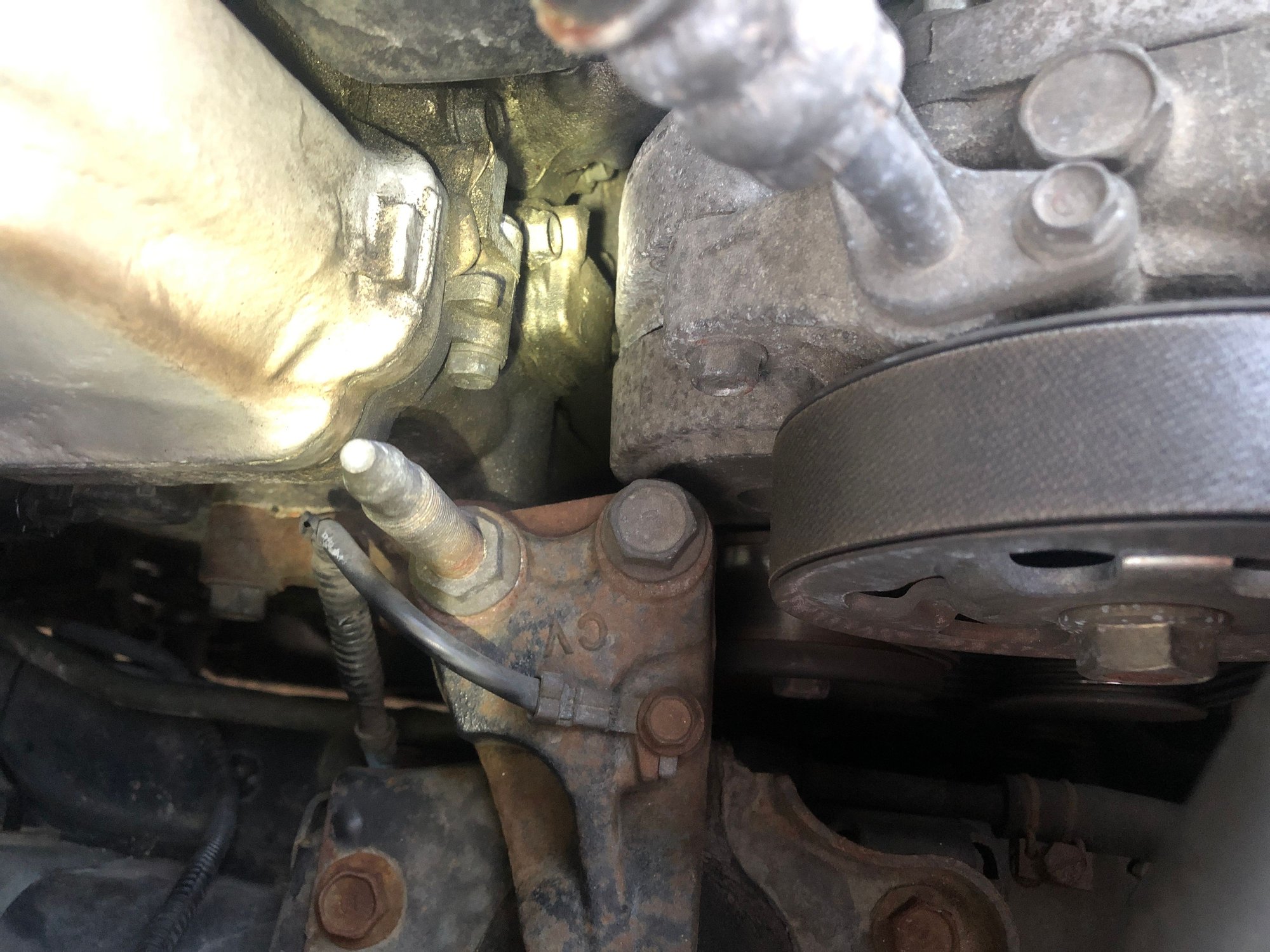

Is this what you are referring to? How do you get to bottom bolt. If you unhook top will it sway like a door side to side?

That is the one.
Remove the power steering pump. That is the best way to access that cover and filter.
Recommend buying a new filter. It is like the VTEC solenoid screen. It is a molded o-ring with integrated screen.

Do I have to remove belt tensioner as well?
Old Oct 11, 2021 | 04:09 PM
Ryanthegreat1's Avatar
Posts: 3,585
Likes: 501
Default Re: VTEC Solenoid
Just the belt to remove the power steering pump.

I remove the tensioner and the P/S mount bracket (they are attached to each other) when I replace this gasket... it makes life MUCH easier.
If replacing the VTEC assembly on the back of the engine as well as the screen on the front of the engine, using genuine Honda parts, doesn't fix your VTEC code... then you likely have low oil pressure and bearing damage at the crankshaft.
