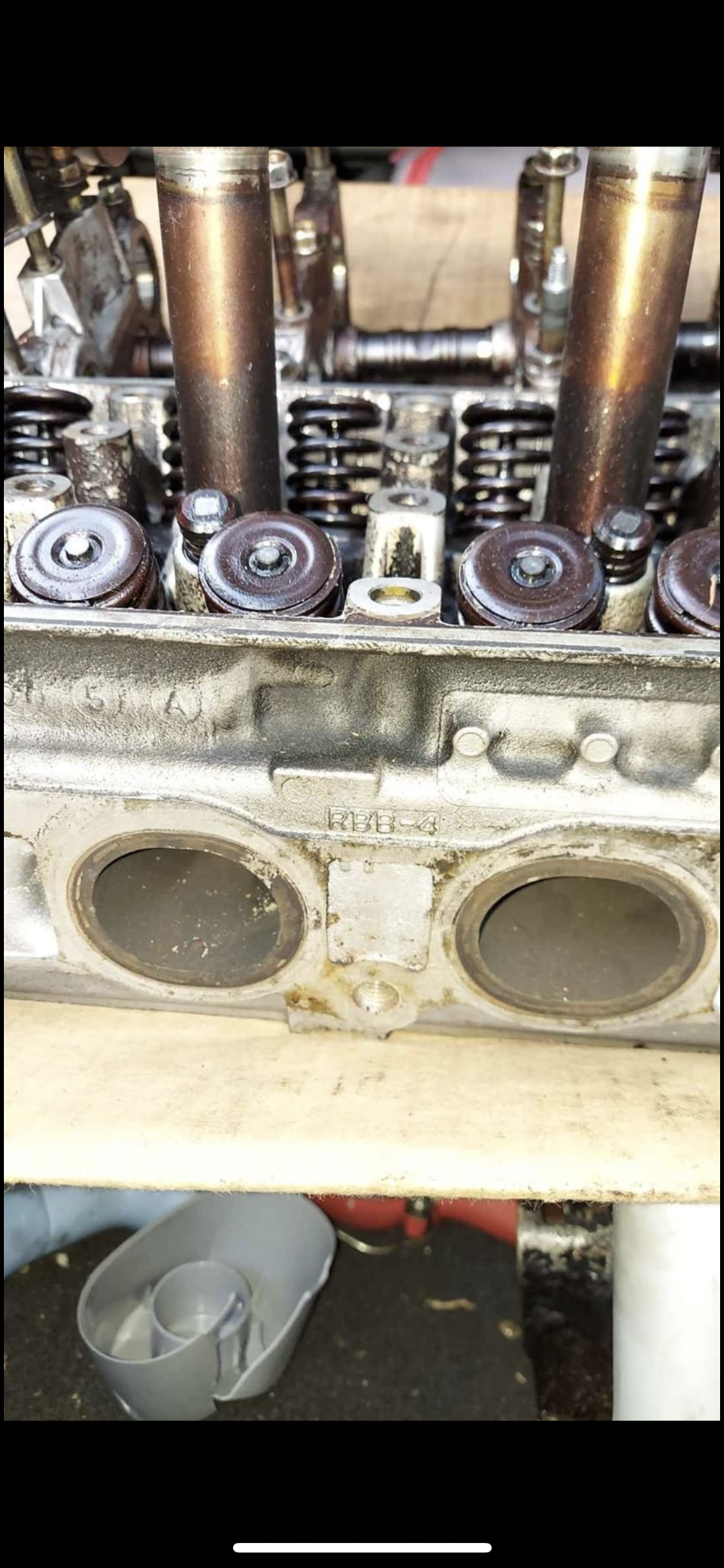

I’m looking for some knowledgeable expertise. I found a cylinder head for a project of mine that’s stamped with RBB-4. Can somebody please tell me what year TSX this belongs to?
I’m looking for a 2006-2008 TSX head. The guy is claiming it’s from a 2008, but cannot find any information verifying his claim. Any knowledge about this head would be greatly appreciated.
Thank you in advance.
RBB-4 “What year TSX does this belong to?”

Measure the width of the intake valve face. What size is it ?

That’s a good idea due to the fact that the intake valve is larger on the 06-08, but the guy lives 100 miles from me.

According to this for sale post, the RBB-4 is from the 07 - 08 JDM Ver TSX.
https://usedjdmengine.com/honda/k24a-type-s/9489
