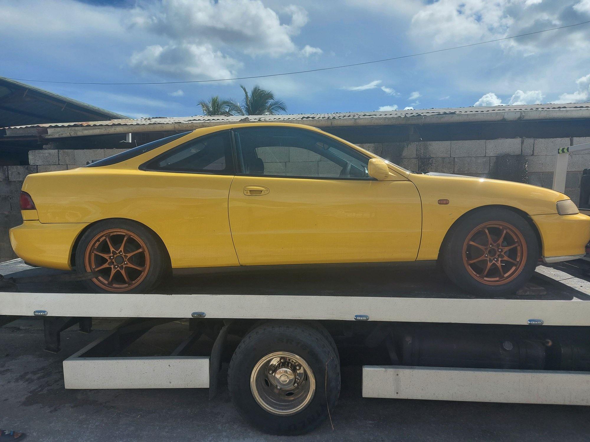

Hey guys!
So i bought my first project car and its a dc1 integra. I would like to put a k24/20 in it and i have so many questions, but right now i just want to know if any kseries manual shifter and shifter cables will work in any kseries manual transmission.
Also is the 6 speed lsd worth buying over a regular 5 speed considering its almost double the price.
Any other tips you guys have for a kswap into a dc1 will be greatly appreciated. Thanks!
Thats my baby
