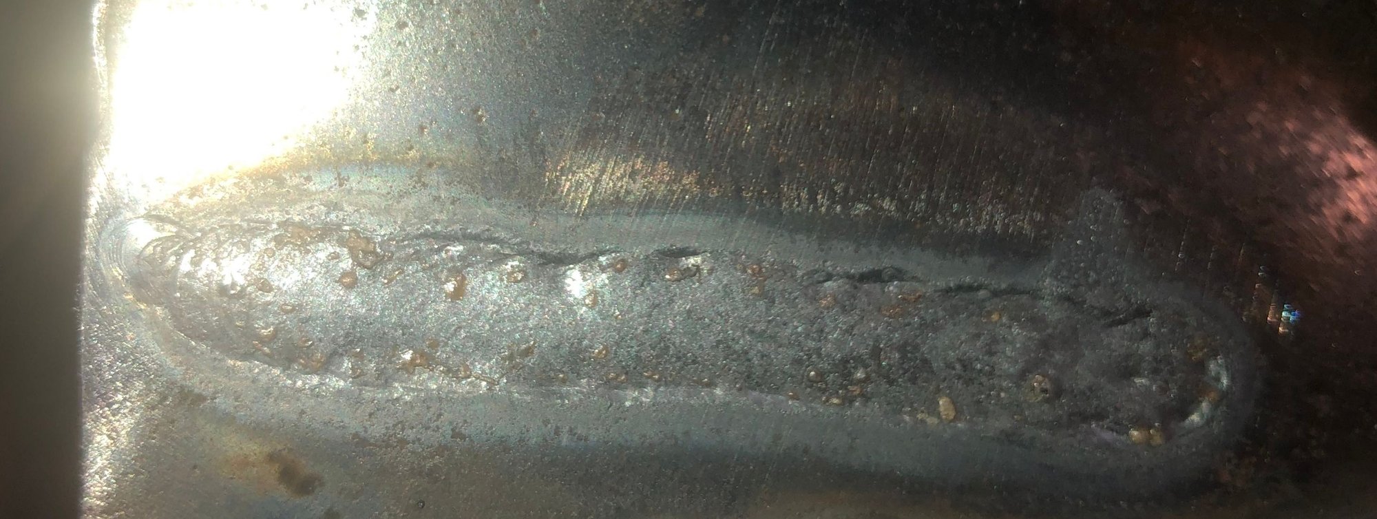

Old Mar 29, 2020 | 10:52 AM
Fusionpuddle!'s Avatar
Joined: Mar 2020
Posts: 13
Default Re: Tig
Just now

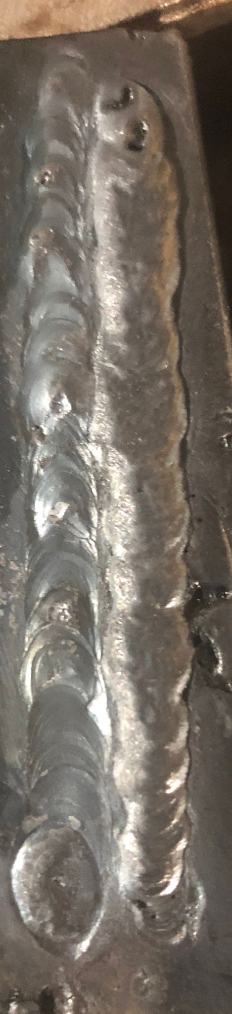

Old Mar 29, 2020 | 02:37 PM
Joined: Mar 2020
Posts: 13
Default Re: Tig
Not instagram 😂
Old Mar 29, 2020 | 02:42 PM
Joined: Mar 2020
Posts: 13
Default Re: Tig
Rubbing my belly and patting my head
trying to get the foot peddle down or up
Old Mar 30, 2020 | 01:35 PM
Joined: Mar 2020
Posts: 13
Default Re: Tig

Old Mar 30, 2020 | 02:11 PM
Caoboy's Avatar
-Intl Steve Krew
Community Influencer
Active Streak: 120 Days
Loved
Posts: 6,838
Likes: 197
Default Re: Tig
Yep, that’s definitely an improvement!
keep it up. With a place like what you are using, just pad beads. Get that muscle memory trained!

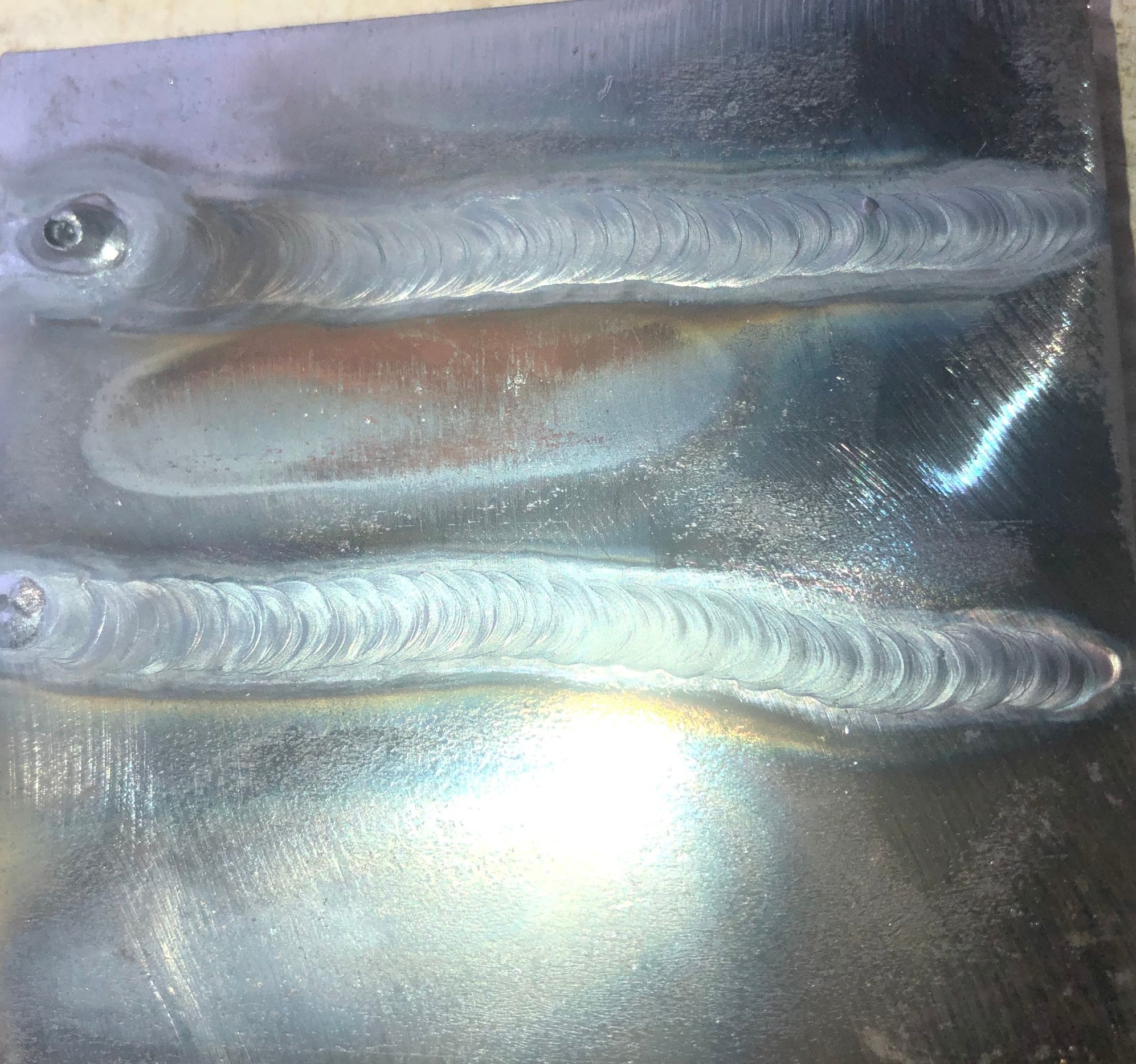

Old Mar 31, 2020 | 05:59 AM
Joined: Mar 2020
Posts: 13
Default Re: Tig
7 cup 3/32 tungsten gas around 12-14
had to cut my Amp back to like 142
don’t quote me but I think that’s where I’m at.
Old Mar 31, 2020 | 06:03 AM
Joined: Mar 2020
Posts: 13
Default Re: Tig
Just over lap by half or not quite half
Old Mar 31, 2020 | 09:42 AM
Caoboy's Avatar
-Intl Steve Krew
Loved
Posts: 6,838
Likes: 197
Default Re: Tig
Bump your gas to 14-21

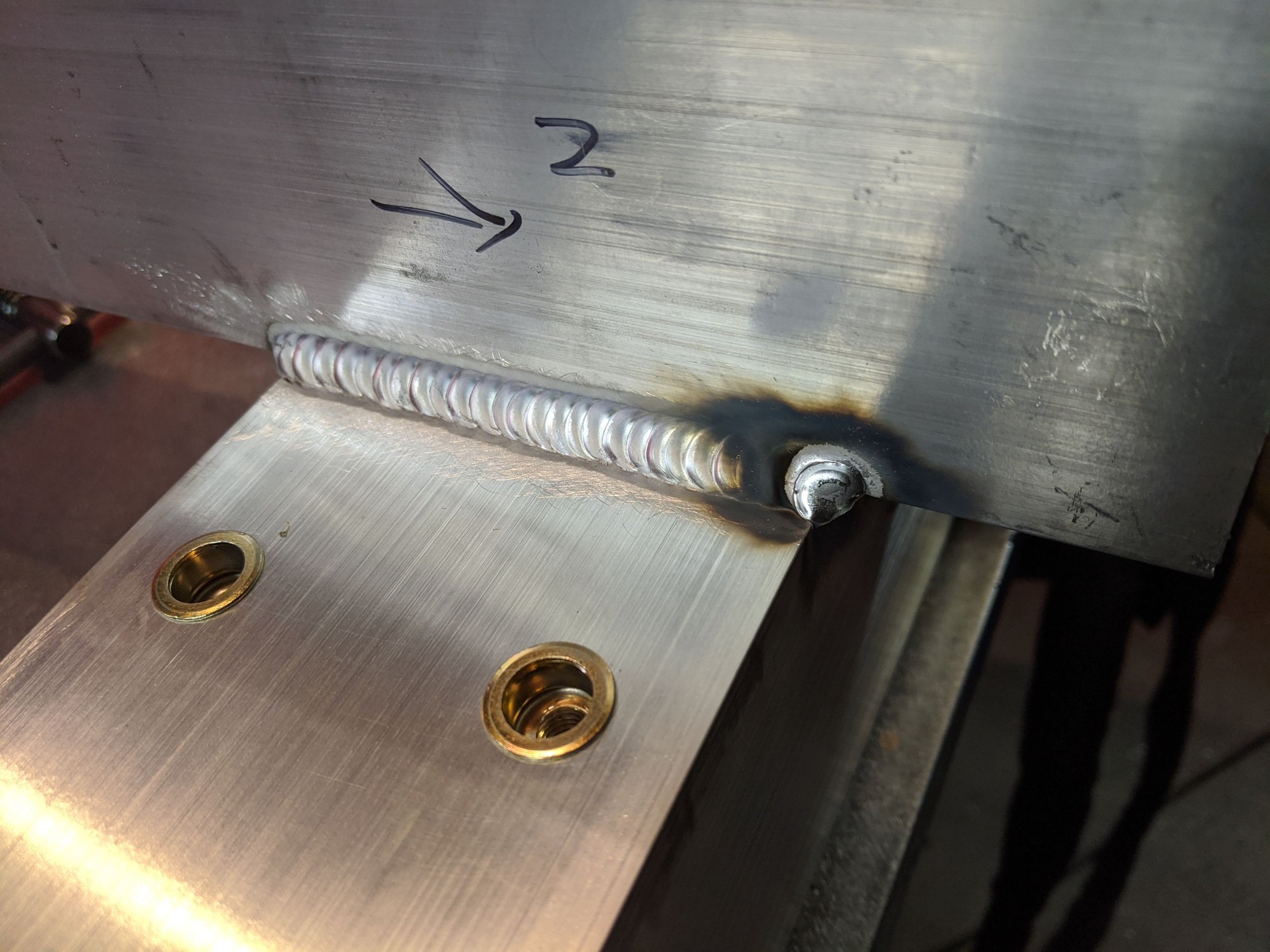

Old Mar 31, 2020 | 09:43 AM
Caoboy's Avatar
-Intl Steve Krew
Loved
Posts: 6,838
Likes: 197
Default Re: Tig
This is what I'm dealing with ..
1/4" AL
