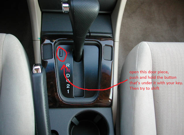

This is an introduction section, not tech help, but I'll indulge you since you're new. Do you have any check engine lights? If you do, you should have them scanned. The car may have bigger problems. You might also try this trick. If you can get the car to neutral it should still start, and maybe you can shift from there.
