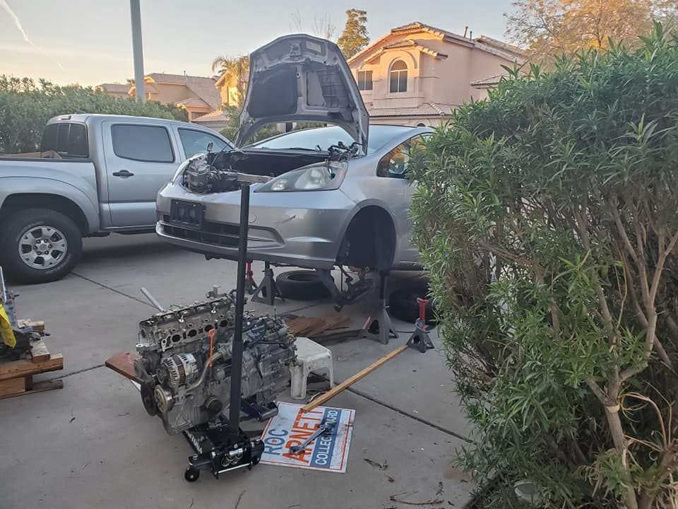

Honda Fit 2011. Basic 4Dr automatic transmission, 1.5L 4cyl. Just replaced an old engine that suddenly died with a newer used engine with 33K miles. Assembled engine does have a fuel injection problem. NOID test showed no pulse in the fuel injectors. Trying to resolve the problem.
Dead engine is out. Still connected to the transmission. Transmission will go back in.
Engine had to be pulled from below the car.

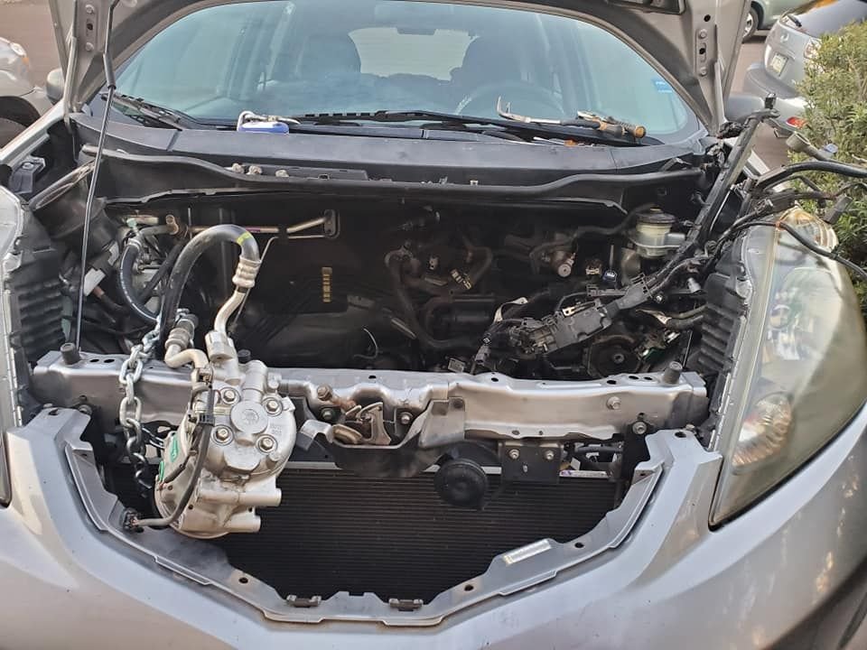

close up
did not have to disconnect the AC compressor, so did not have to recharge it later

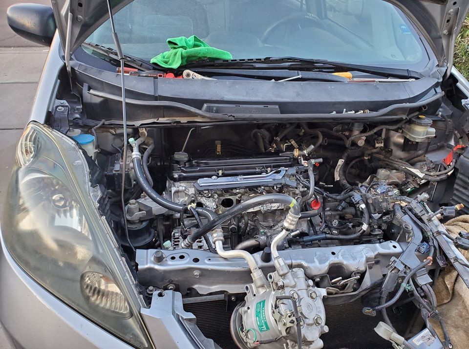

New engine is inside. Had to pull it in from below the car inch by inch, turning and adjusting the engine and transmission to get it through the frame.

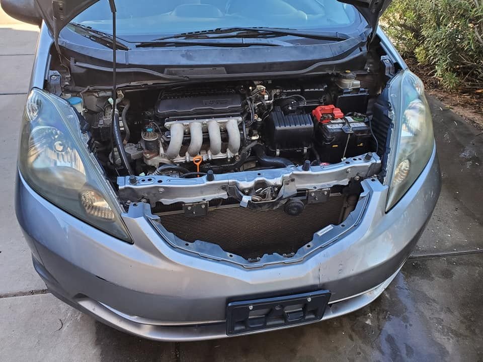

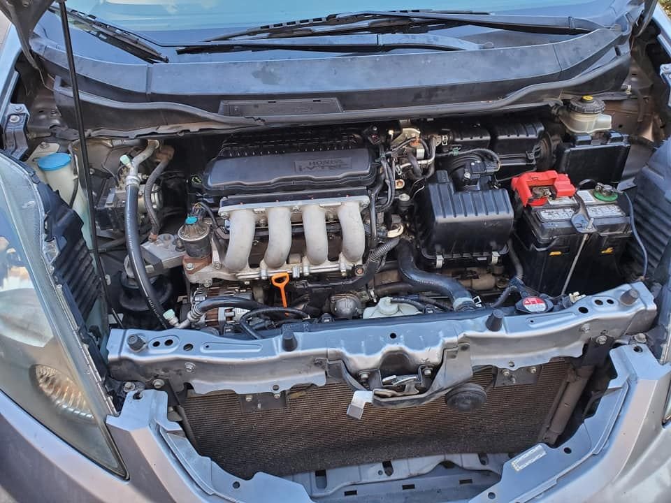

Fully assembled engine
close up
