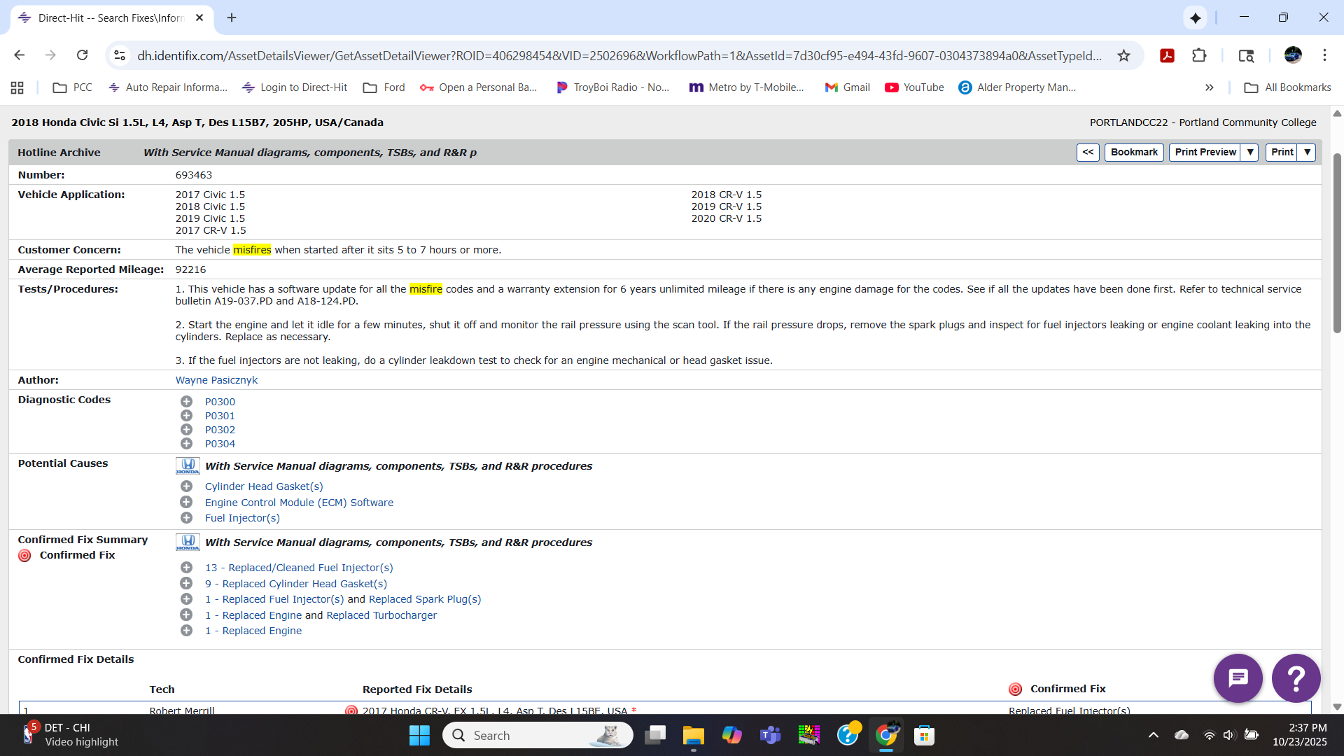

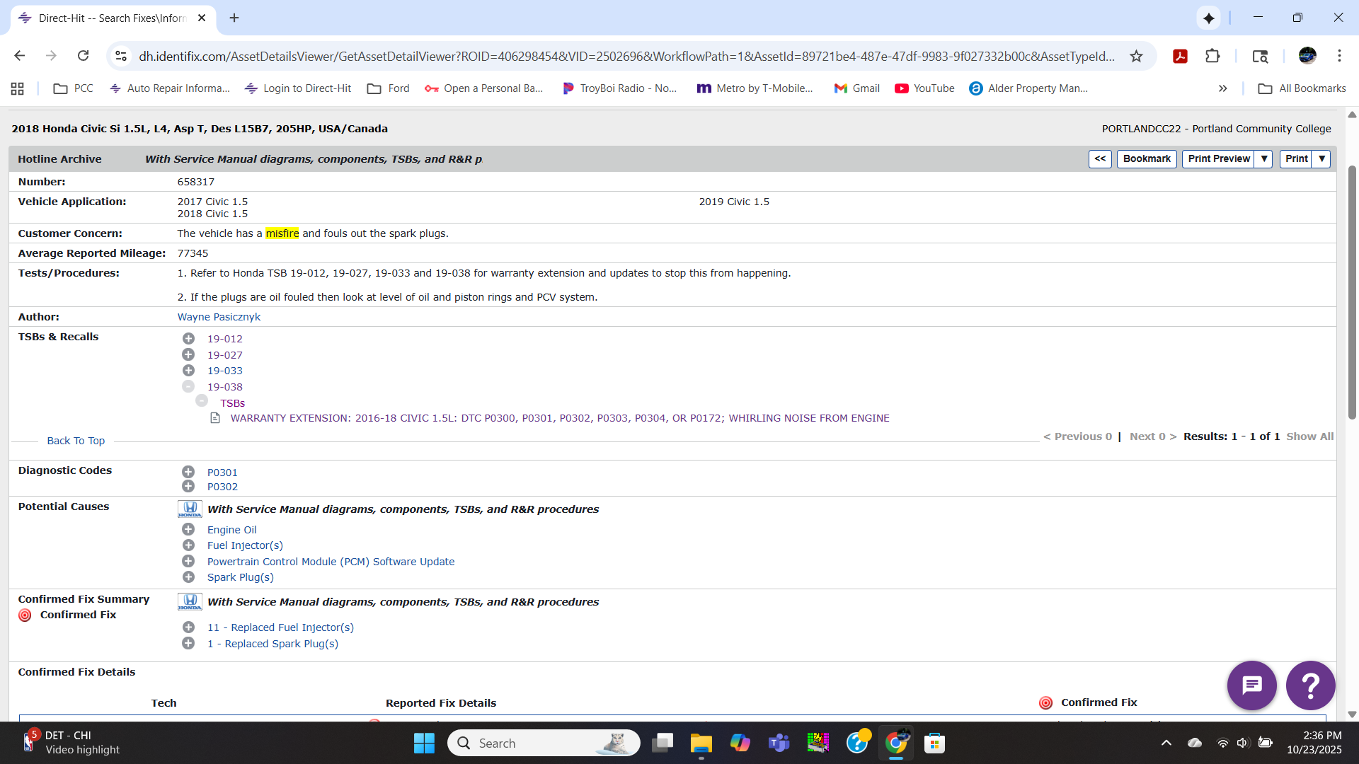

Here's the funny thing, I actually came here seeking knowledge and guidance? My car has recently begun acting kinda chitty to me. It randomly set the check engine light and set a P0712 (rich bank 1) due to the minimum fuel trim threshold being crossed on the LTFT (LTFT= -25.00%) Upon investigating I found that my blow by gasses were seriously high. When removing the oil filler cap while vehicle is in idle, the gasses were shooting out, hitting the underside of my hood and blasting me right in the forehead. Now, I couldn't find any info ANYWHERE that had an exact amount of pressure that is allowable for the blowby gasses to be but to me, that seemed a bit excessive? I also found that all around the top of the block, there was oil seeping out the head gasket. Long story not so long, I tore the head off to replace the gasket and found that injector 4 was clogged up for god knows how long and the inside of my INTAKE manifold was full of carbon and unburnt oil/fuel. The EXAUST manifold was clean as a whistle! I think it's supposed to be the other way around right? My biggest issue is I may have slightly modified the car over the years and most of the parts under the hood are aftermarket but my problem is this! This issue that i am having is almost exactly the same issue that other vehicle of the same year, make and model are also displaying and on stock internals!
File Type: pdf
