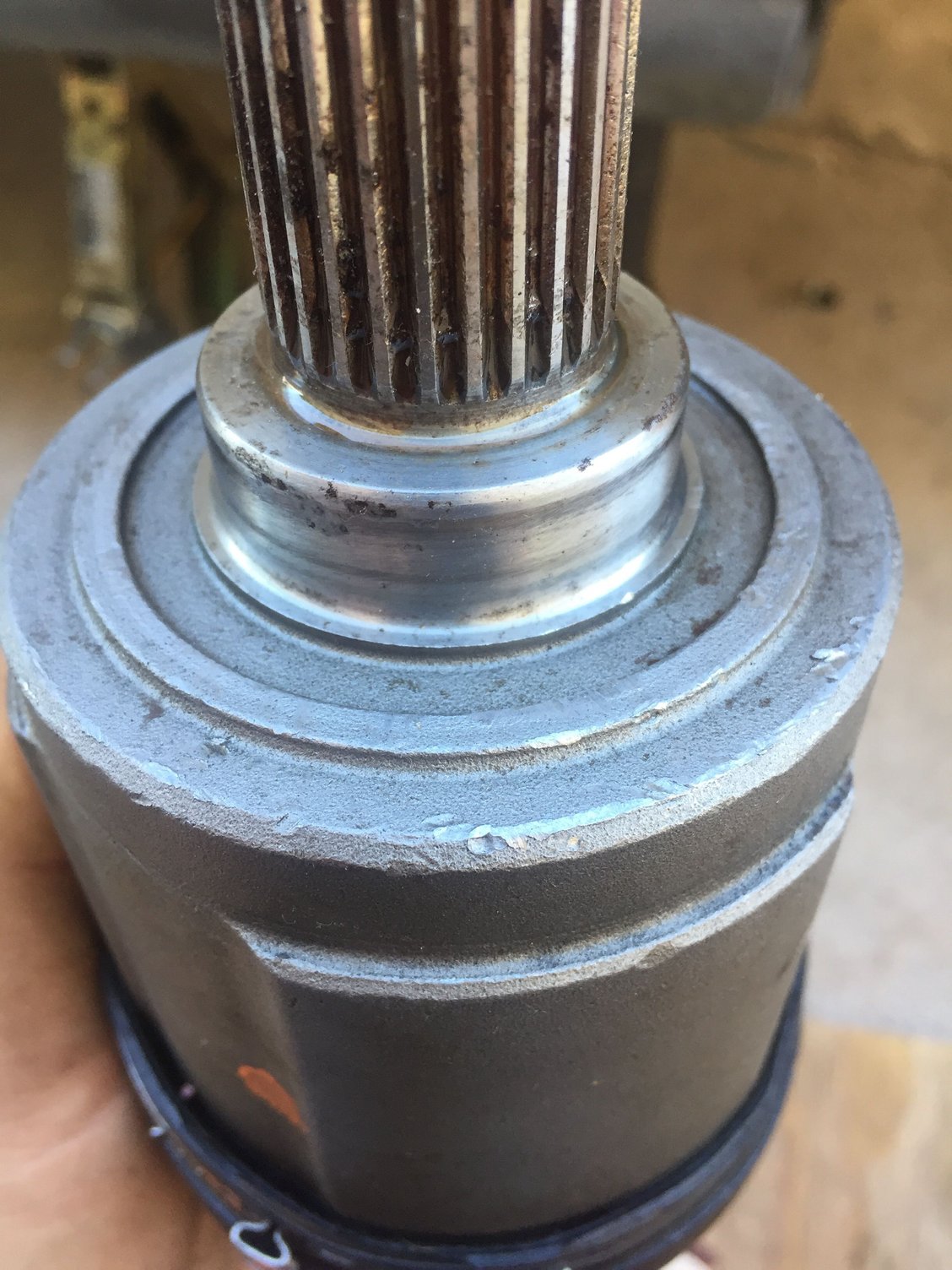

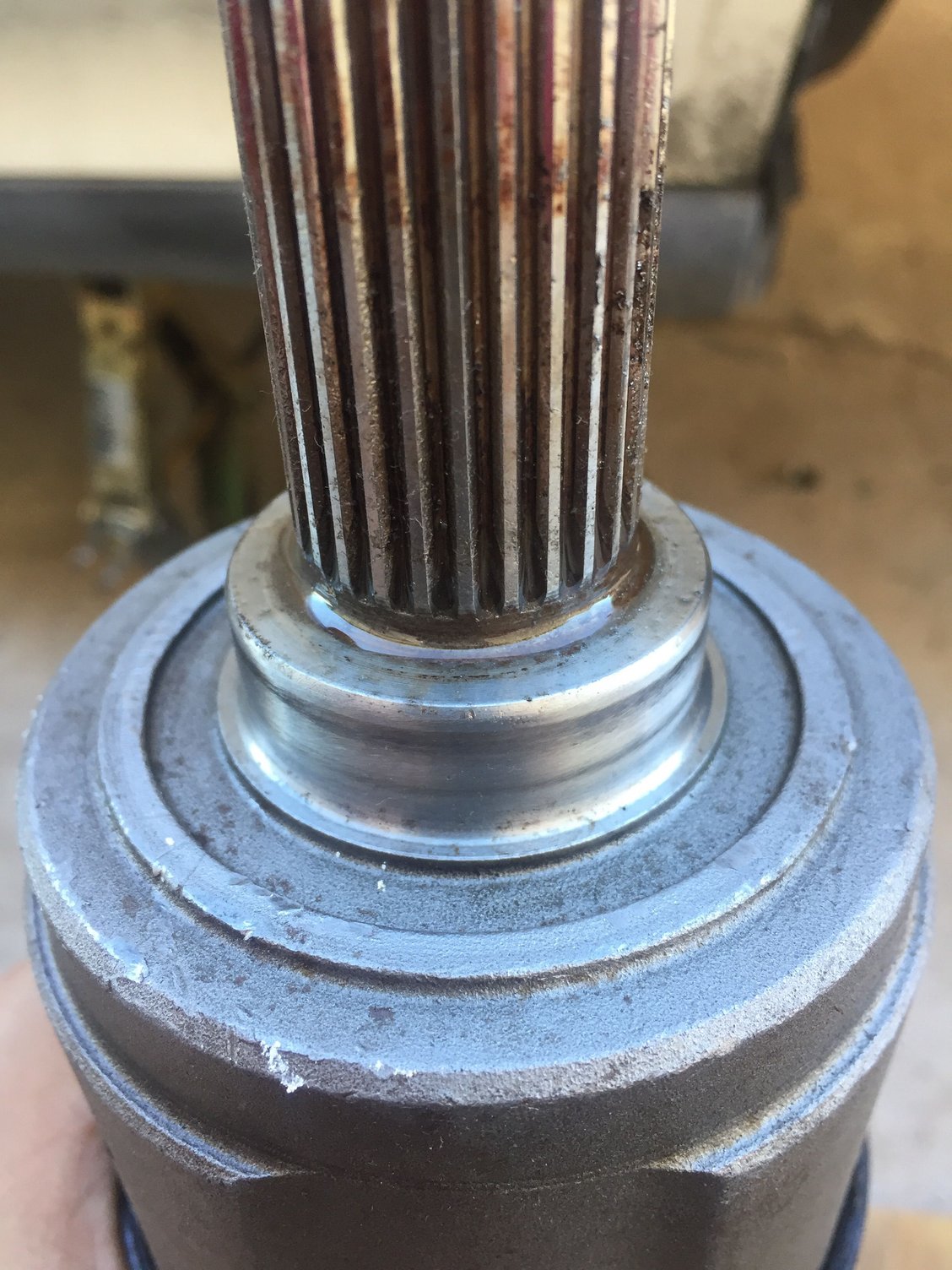

Oh I meant RTV like on the outside not inside the hole where seal goes but on outside of tranny around the seal not on it where axle hits the seal and tranny?
Old Oct 15, 2017 | 02:39 PM
S2kjulian's Avatar
Joined: Feb 2017
Posts: 25
Default Re: Leaking transmission fluid
THats how axle looks
