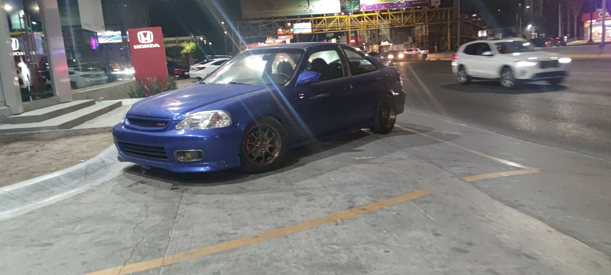

I'm undecided on which trees to run, my goal is something for daily use but to give it a hard time from time to time. What I have so far is the following b20z2 block Nippon racing pistons scat cranks Arp in stock Cometic board arp in connecting rod New three-layer king race metals on the bed and connecting rod block guard acl oil pump b16a head Double springs, retainers and skunk2 padlocks. 1000cc rc injectors aem pump 340bhp Skunk2 ultra intake with 70mm body Lightened toothed ring Clutch stage 3 I am undecided on what trees to run and get good numbers can anyone help me with their experiences? I currently have one more b16a in the chest, however I make long trips and in my opinion it is poor in torque
