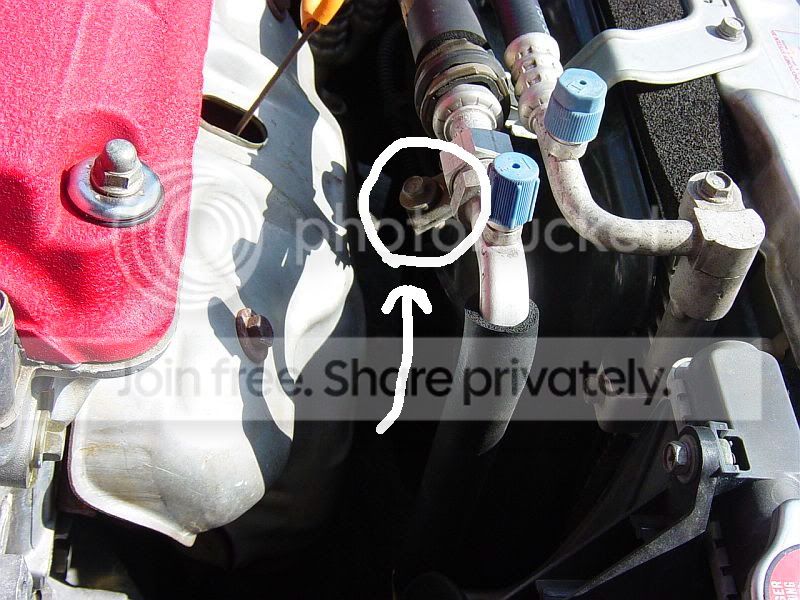

I have a 99 Civic with a B-series swap. This may sound stupid but I thought I would ask anyway. Will an aftermarket header like Greddy or DC stick out the same amount as a Stock header? The reason I ask is that the other day I tried to take my heat shield out and could not, The a/c fan was in the way. I was just wondering if an aftermarket header will fit in there fine? I am worried it wont.
Is there anything I can do to get the heat shield/header out without messing with the A/C? And no I am not going to take away a/c.
Here are pics of how tight the spot is:

I think this is one reason its not coming out:
Its getting caught on that.

You can get it out if you force it out past the A/C lines. You need to first get the top power steering bracket out of the way and you have to unbolt the A/C line bracket that holds the line to the A/C fan. I was able to just slip it out by angling it out just a little to the driver side and pushing the A/C lines as far back agaisnt the condesor. You also might consider wrapping some heat insulator around the A/C lines if you are gonna run without the heat shield...

I dont think the power steering bracket was in the way. Is the A/C line bracket the thing I have circled in the most recent pic? Where would I get heat insulator? I am planning on getting an aftermarket header.

Oh ok. Is the A/C line bracket the thing I have circled in the most recent pic?

I was not talking about it being wrapped up, This is what you said:
<TABLE WIDTH="90%" CELLSPACING=0 CELLPADDING=0 ALIGN=CENTER><TR><TD>Quote, originally posted by JeffBro &raquo;</TD></TR><TR><TD CLASS="quote">unbolt the A/C line bracket that holds the line to the A/C fan</TD></TR></TABLE>
I was asking if the A/C line bracket is what I had circled?

oh yeah. for some reason mine looks different. hmm i am gonna go take a picture u got me curious.

Here is what mine looks like:

I dont understand why that bracket is holding you up. Tho I cant tell whats going on in those pics cause u can only see the hose and the top of the bracket. On mine the bracket is just bolted to the fan as you can see in the pictures. and the other part that is around the hose is just sitting there out of the way...

I guess yours looks different b/c its a 96 Civic and mine is a 99.
<TABLE WIDTH="90%" CELLSPACING=0 CELLPADDING=0 ALIGN=CENTER><TR><TD>Quote, originally posted by JeffBro &raquo;</TD></TR><TR><TD CLASS="quote">I dont understand why that bracket is holding you up. Tho I cant tell whats going on in those pics cause u can only see the hose and the top of the bracket. On mine the bracket is just bolted to the fan as you can see in the pictures. and the other part that is around the hose is just sitting there out of the way...</TD></TR></TABLE>
I dont understand it either but what what else would be holding it up?

oh and there was one other thing that I forgot about. There is a bracket under the car that holds the low pressure a/c line that I also had off which allowed me to push that line thats closest to the heat shield back more. also you can unbolt the compressor and hold that back as well. The bracket is covered up by the plastic skid plate but with that off and someone holding the lines back you might be able to get it out like I said before. I didnt think it was gonna come out but I went to town on it and it finaly came out. Just dont brake the lines.
