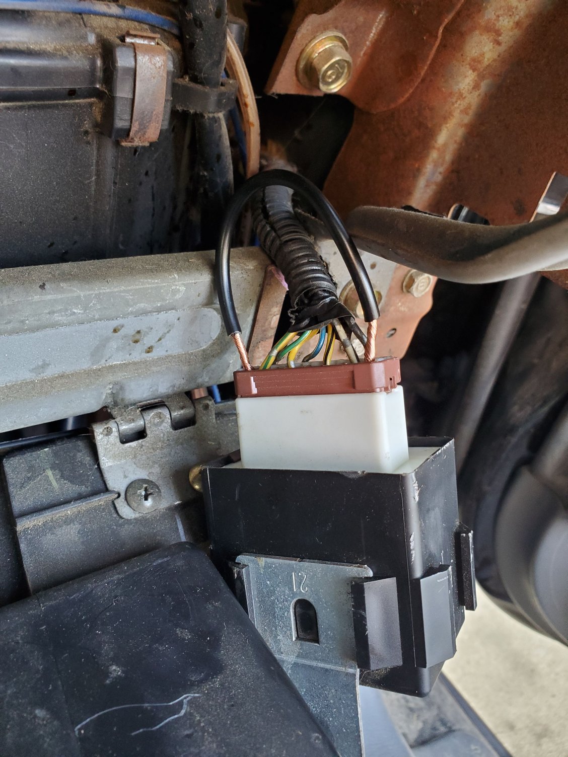

Anyone have a clue? Can it be that the ecu jumper harness is no good? I know this is frowned upon but when I jump the fuel pump at the main relay, engine starts and idles with p72 ecu but when I try to give it a little gas, it bogs so I think its no more than just a fuel issue.
