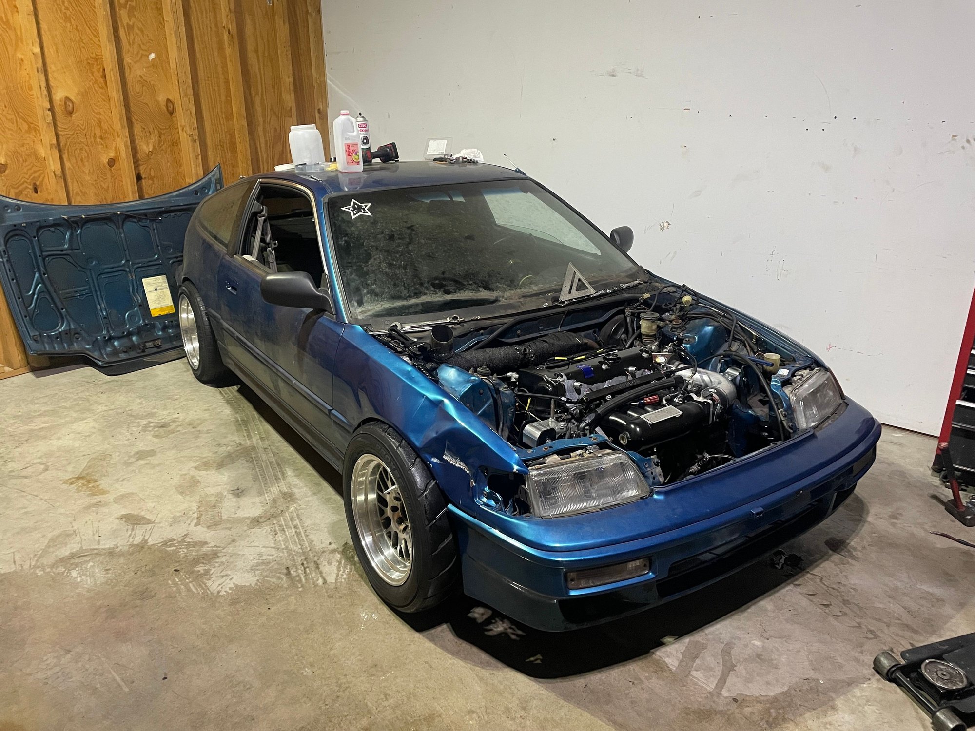

Need some help! Im in the process of K swapping my CRX, its pretty much done but I’ve ran into an issue where i am not getting any spark. The swap with harness was pulled from a running car so i k
now that side of things is good. Its running on fuel Tech450 , engine is grounded, Harness is grounded , not sure where to start. Ive checked Can on the fueltech and i am not getting any codes/Issues .
