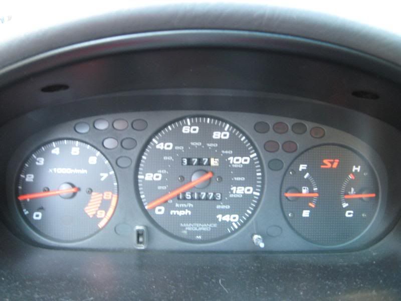

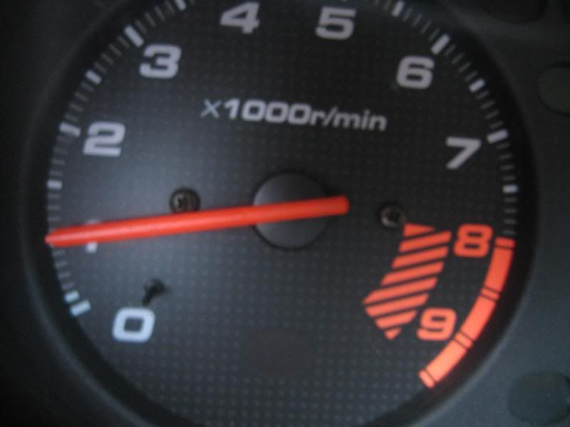

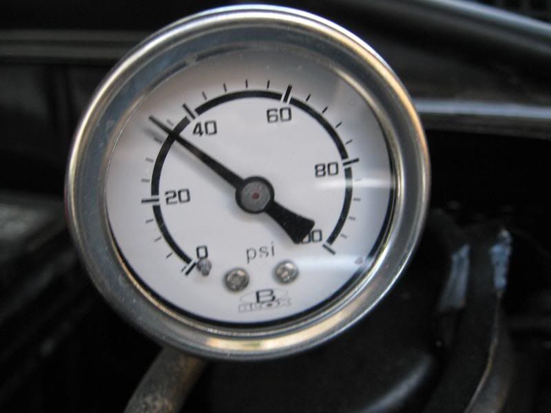

I have an h2b in my civic ek hatchback.. My problem is that the motor doesnt idle lower than 1000rpms.. is it due to me disabling the balancing shaft belts? I heard doing so will make it idle a little more rougher.
Heres a picture of my fuel psi and my idle. Its a stock motor with headers and air intake. The ecu is also a stock h22 basemap with the egr disabled chipped by phearable.net

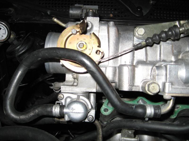

From: CA
Default Re: h2b problems?

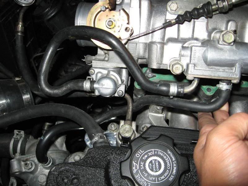

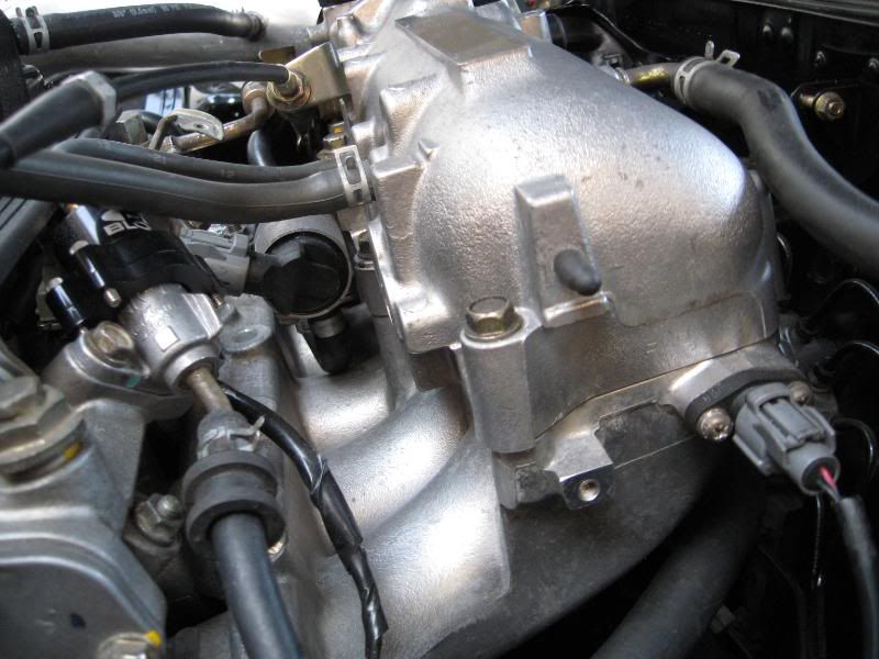

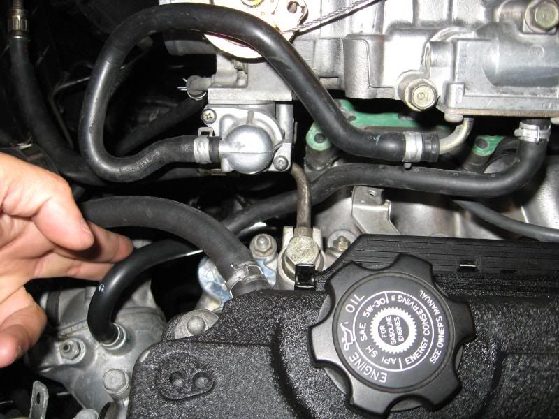

here are more pictures I took
is this the correct way to bypass the egr and hook up the hoses from the thermostat, and the FITV to the IACV? I have an egr blockoff plate as you can see

dump response here but.... have you turned the idle screw on your throttle body??

lol yes I have.. and I also adjusted the tps sensor which is strange because it only allows me to adjust to about 580 which is the lowest I can go.. and thats with the idle screw turned closed all the way.. helped my idle a bit now it goes a little below 1000rpm

My issue was kind of like gibanez's when I had my stock manifold. Just had a bunch of problems with the sensors but now I cant have them. Do you have any vacuum leaks that you know of tb, manifold, and iabs all sealed up good?

thats what I was thinking off.. I dont think I have any vacuum leaks because the idle is steady.. I might have to replace TB gasket as well as tps gasket and maybe the manifold gasket since I took off the IAB plate. Dont get me wrong motor runs and hauls ***!! I love this motor.. I can accelerate on the freeway on 5th gear and just pass everyone.. but my problem is the stinkin idle :[

after the iab is removed and there can be a small vacuum leak. i think its on the back side of the manifold. ill ask my buddy tomorrow and see if he remembers the exact location of the leak. he had a hight idle issue for a wile untill he fixed it. i still have the iabs in my ej6 so i dont have any idle issues. will be upgrading to a black tracks ported stock manifold soon.
EDIT. i noticed that you said you have a chipped ecu running a basemap. i had a surging idle issue before my car was tuned. once i got tuned no more erratic idle. now my idle stays around 750. what city do you live in? my friend owns a shop in vallejo and he does amazing street tunes. and he has a good amount of tuning knowledge with h2b's
Old Jan 24, 2010 | 04:49 AM
NAH2B's Avatar
Joined: May 2008
Posts: 4,062
you have a vaccume leak on the front side of the manifold.
heres how to fix:
*remove iac and make a solid block off plate or tig weld the holes. mount the iac somewhere else but leave it pluged in so you dont throw a code.
*remove tb and make a new tb gasket w/o the holes for idle/fitv. basicaly a solid gasket w/ only holes for the 4 studs/bolts and of course the tb bore.
problem solved
