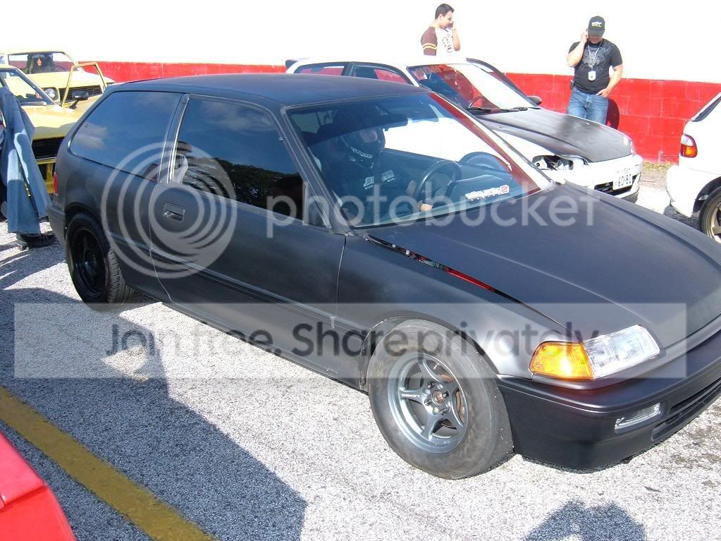

you can cut the hood like this
or you could space the hood up in back like this

i think ill go with pic number two even my B swap wouldnt fit witout it being spaced one inch with hasport mounts so whats another one to two inches more.
