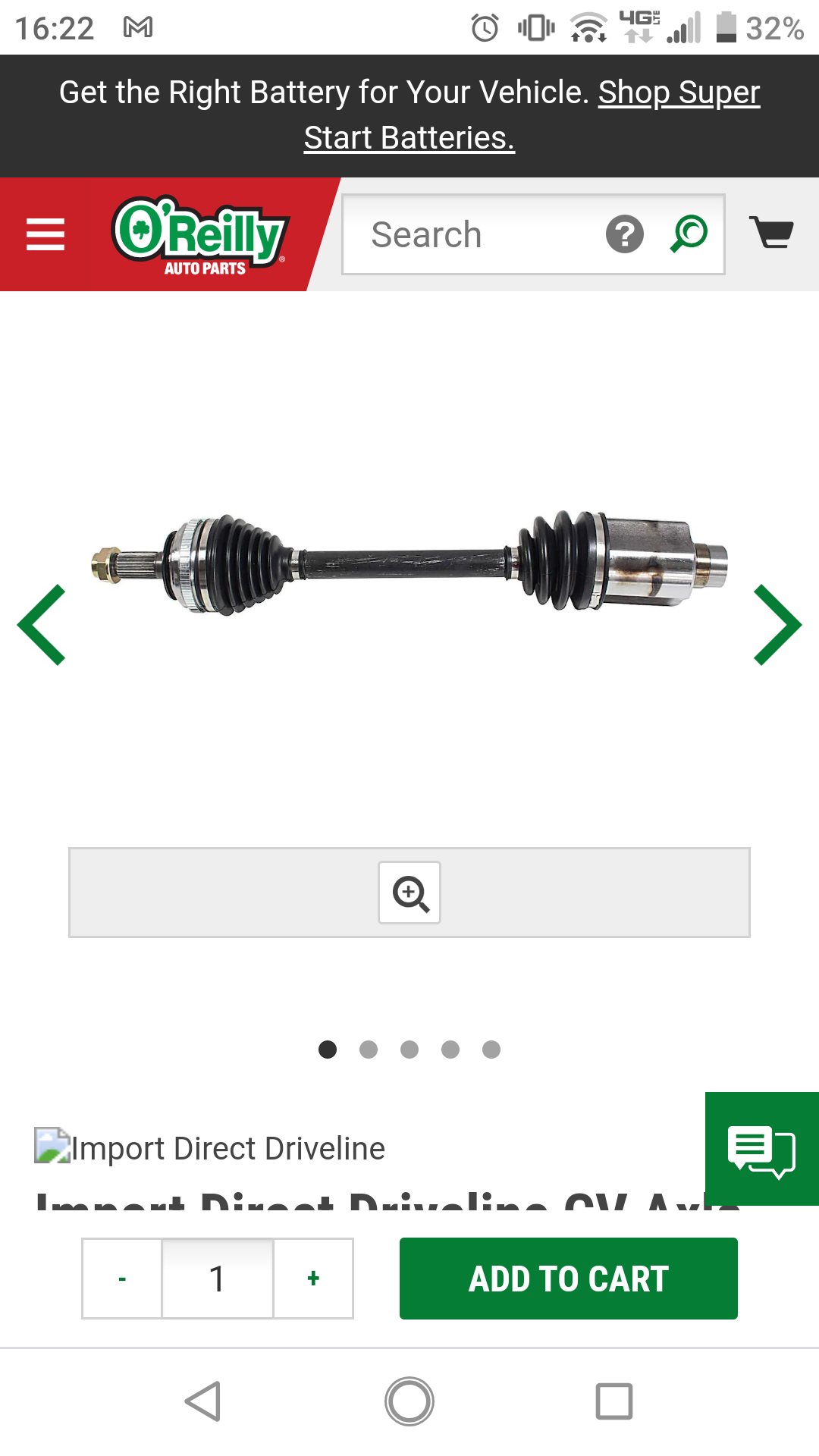

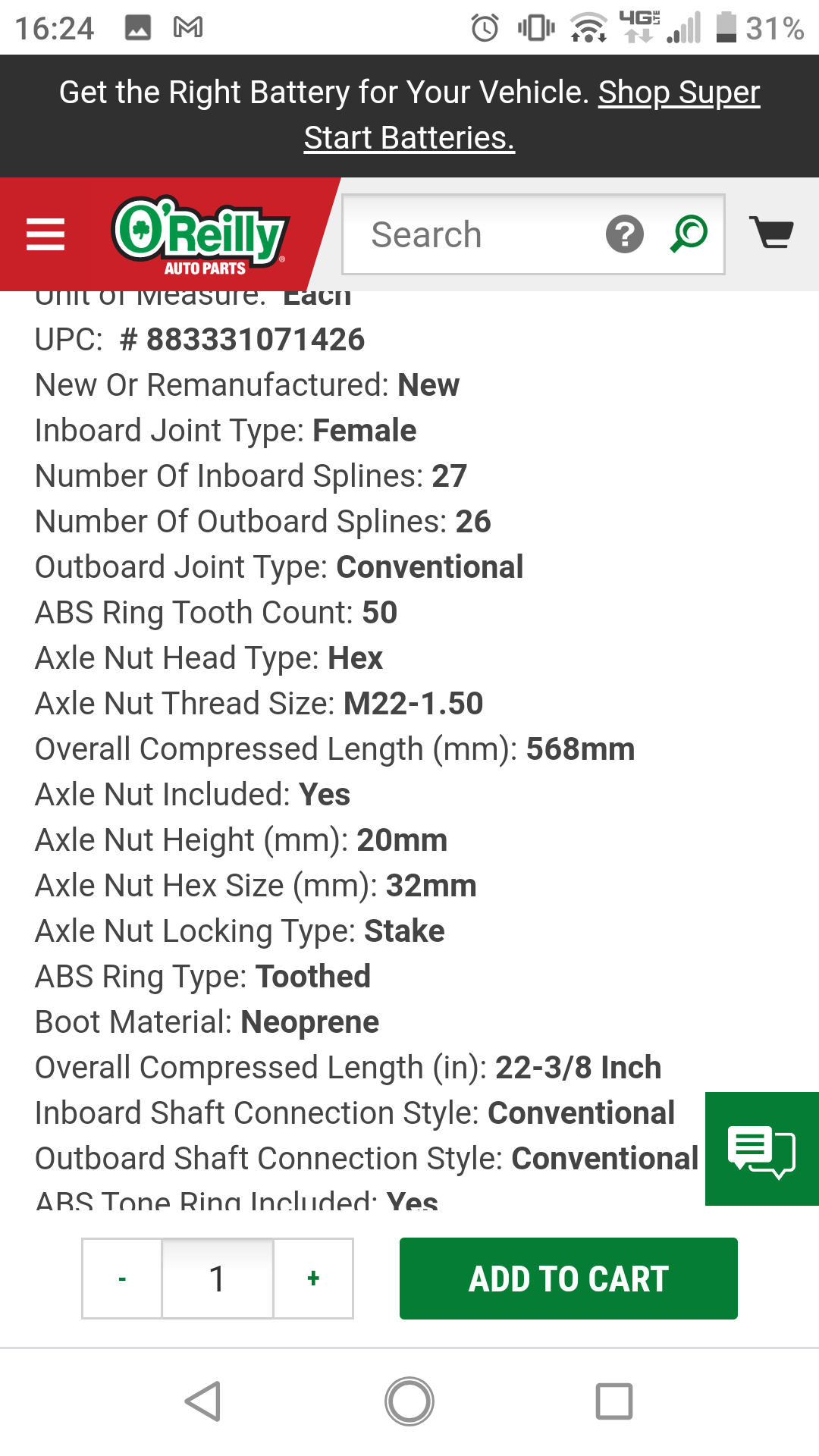

Basically i don't have the right parts. bought cr-v parts not knowing. now i measured the old axle i pulled out. axle measures compressed 22 3/8 inBasically i don't have the right parts. bought 2000 cr-v parts not knowing. now i measured the old axle after i pulled it out. the drivers side axle measures compressed 22 3/8 in, 26 splines outboard and 27 inboard.
based on these specs sounds like a vtec del sol axle is the exact one but i don't wanna buy it if i don't have too and i assume the passenger one without pulling it out would be the passenger side del sol axle as well.
im really just hoping some one with same or similar swap can help me out a little. I hope to learn more about this swap and other b series swaps. i bought it with the swap.
my swap is a b20z2 in a 5th gen civic coupe ex. below is drivers side axle i think i should buy.

b20 swap with hydro transmission and hydro intermediate shaft into 92-00 civic can use 94-01 integra axles, 99-00 civic si axles, 94-97 del sol dohc vtec axles
