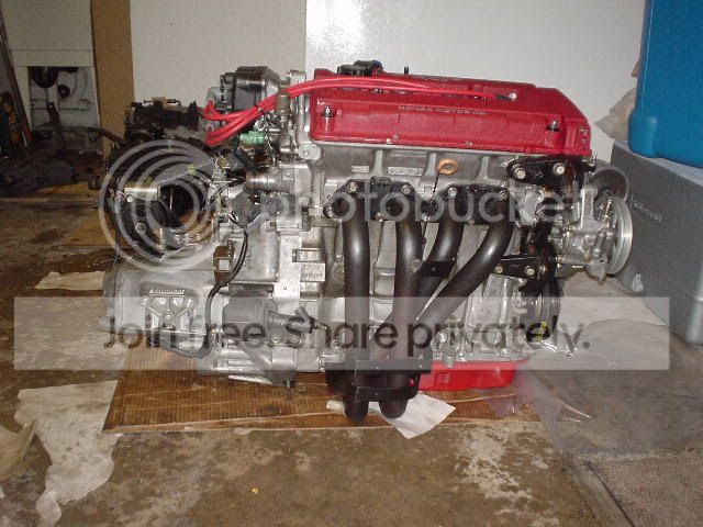

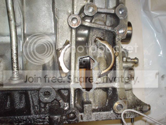

before
after
I built a crvtec twice and this happened both times. This is my over all sumery.
It was preaty cheap to build. defenetly had a Sh*t load of power. What i used in this build was a stock b20b and stock gsr head/tranny. the guy who changed a couple of my valves after the first motor said that i had dual springs. what i think the problem was is my computer spoon fuel map i think it was 5000 vtec 9500 redline. everything was great it seamed like it wanted to go past 8000 guess i was wrong. There were a few signs first was somtimes it would blow the plug wires of the dizzy at extreme high rev don't remember when put zip ties on them to fix the prob. second was it used to blow the dip stick out at about 8700. never had a chance to fix that. i know your all thinkin . but it was so hard to control myself with a rev hard motor.
anyways i belive to get reliability out of this motor would be to change the rods and proper fuel management and there shouldn't be a prob. also WATCH YOUR OVER REV!!
I gave up on that its the F20b/gsr now!! 2.0 forever!

Haven't built my b20 yet but I'm told a GSR crank girdle helps alot with the high reving issues
