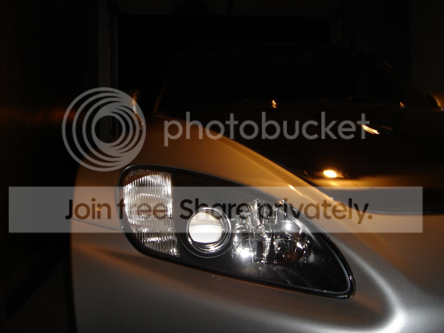

Posting pics.....damn this sucks. Oz do joo know how to adjust the beams? I've been doing it for like an hour and want to throw things across the room.
Trust me guys....it does'nt look right at all.
Teaser pics of the lamps and the new hood. I'll post pics of everything tommorrow when Oz helps me with my Craft Square mirrors.

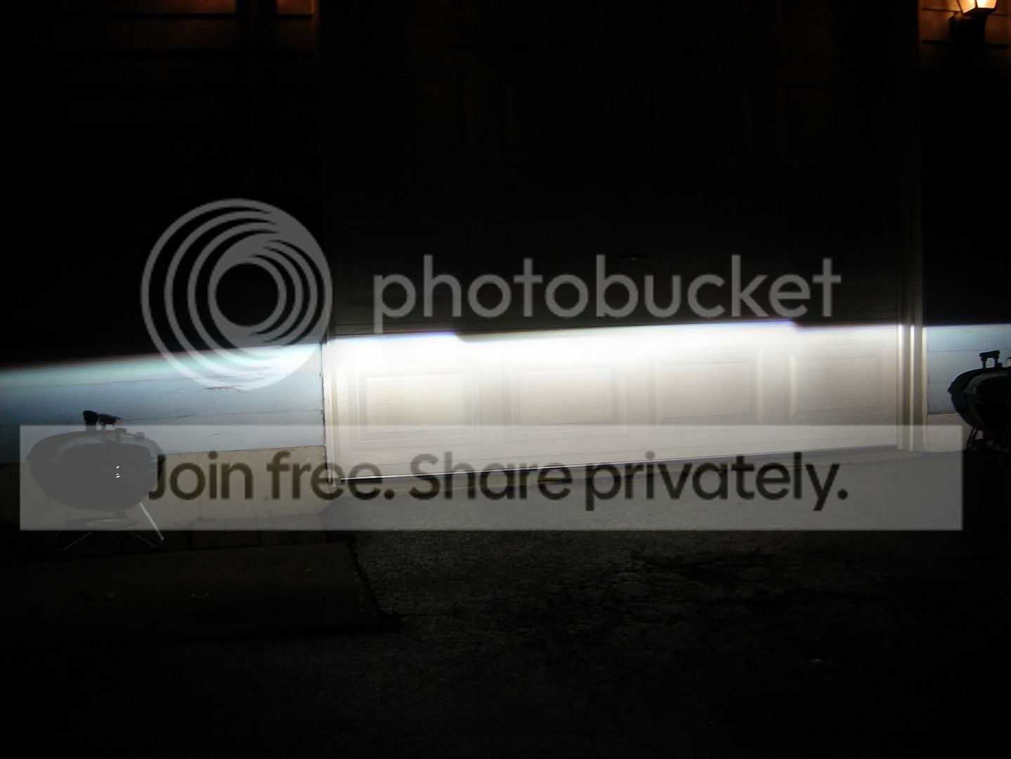

damn those pics came out HUGE.....sorry guys these pics don't show what i'm talking about...i'll go take some more. I'll be back.

Thats why I wanted a pic of someone elses beam pattern. You would'nt believe what my beam pattern looks like now.
I do understand that the drivers side beam will be higher, but I LOST the "wide" beam pattern that the light originally had. It looks bad.

According to the ^^^ pictures, it looks pretty close.
Old Nov 4, 2005 | 10:48 PM
revvin9k's Avatar
Posts: 2,745
From: TRY IT..dare ya. ;)
Default Re: Someone please post pics of the beam pattern on a wall (Slideways2000)
That was my question, are there supposed to be two lil humps in the beam.....or just one? Do you also see the lighter line just above where the hump is? I want that crisp line like when I bought it.

From: Orange County, CA, USA
Default Re: Someone please post pics of the beam pattern on a wall (S2K NUB)
Two humps bro. Mine has two.

Do you see the lighter line?

<TABLE WIDTH="90%" CELLSPACING=0 CELLPADDING=0 ALIGN=CENTER><TR><TD>Quote, originally posted by Slideways2000 &raquo;</TD></TR><TR><TD CLASS="quote">Two humps bro. Mine has two.</TD></TR></TABLE>
Well I am a COMPLETE TOOL and moved the far right hump to be even with the left one, hence the reason my beam was'nt wide as it was before.

<TABLE WIDTH="90%" CELLSPACING=0 CELLPADDING=0 ALIGN=CENTER><TR><TD>Quote, originally posted by S2K NUB &raquo;</TD></TR><TR><TD CLASS="quote">
The lighter line is supposed to be the remnants of the other side's cut off. Each side has a distinctive cutoff line, and a lighter one below that. Do you see both?
Like I said, it looks close to mine, but it also looks like youre on a driveway, which is slightly inclined. It says aim the headlights on level ground.
As bonged out of my mind as I am, that made sense and I see what needs to be done. thanks for being up Sideways, I owe you a beer, or a bong.
I aimed em on level ground, I just needed that for a reference pic.
No beer thanks, enough drinking for the night. Hahhahahahhahahahaha I work better bonged.
As far as your headlights man, it might need just a little adjustment, height wise. I already see the distinctive "double hump", there's supposed to be that lighter line where the two humps cross anyways.
