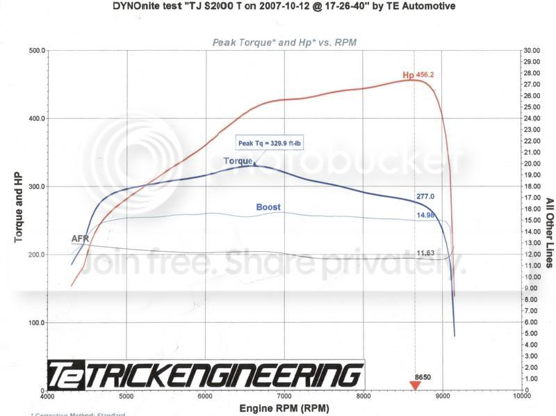

hey, guys just a video of my s2000 from this weekend.
dynoed with pump gas 93oct and 14.9 psi

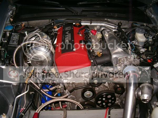

details on motor set up....

Nice total numbers but wow, takes awhile before it hits full boost.

Yeah really, what turbo are you running?

my set up is:
stock motor
aem ems stand alone
lovefab mini-me manifold
gt30r turbo 63a/r
precision 600hp intercooler
homemade intake manifold
rc750 injectors
255ld walbro fuel pump
b&m fuel pressure regulator
most important, 3 mm headgasket for big #s
3 inch exhaust

gt30 with .63 should get to full boost way faster than that.
mini me or not

lets see this HOMEMADE IM... im sure its hurting

these # are actually 10% lower compared to dynojet,so the car is really making around 500hp so i dont think the intake manifold is hurting at all. we talking about 15psi here with a 3mm headgasket. i think the intake manifold is helping alot.

While it would require a slight retune since you've tuned the car to your homemade IM, I'd try swapping out the homemade IM with the OEM and retune. It appears the plenum on your IM is larger which might hurt throttle response but you're making over 400hp so who cares.

Im diggin the intake manifold.

I also dyno'd my car on a dynomite, and the numbers were somewhat low compared to others. may i ask you who told you this ? couldnt find much searching around.

i made 307hp and 235tq @ 14 psi with the ultimate racing kit + 3mm headgasket on the dynamite dyno and then i dynoed on a dyno jet and it made 336hp and 242tq so it's about 10% lower. a few people told me the same but i'm not sure if it's true.
