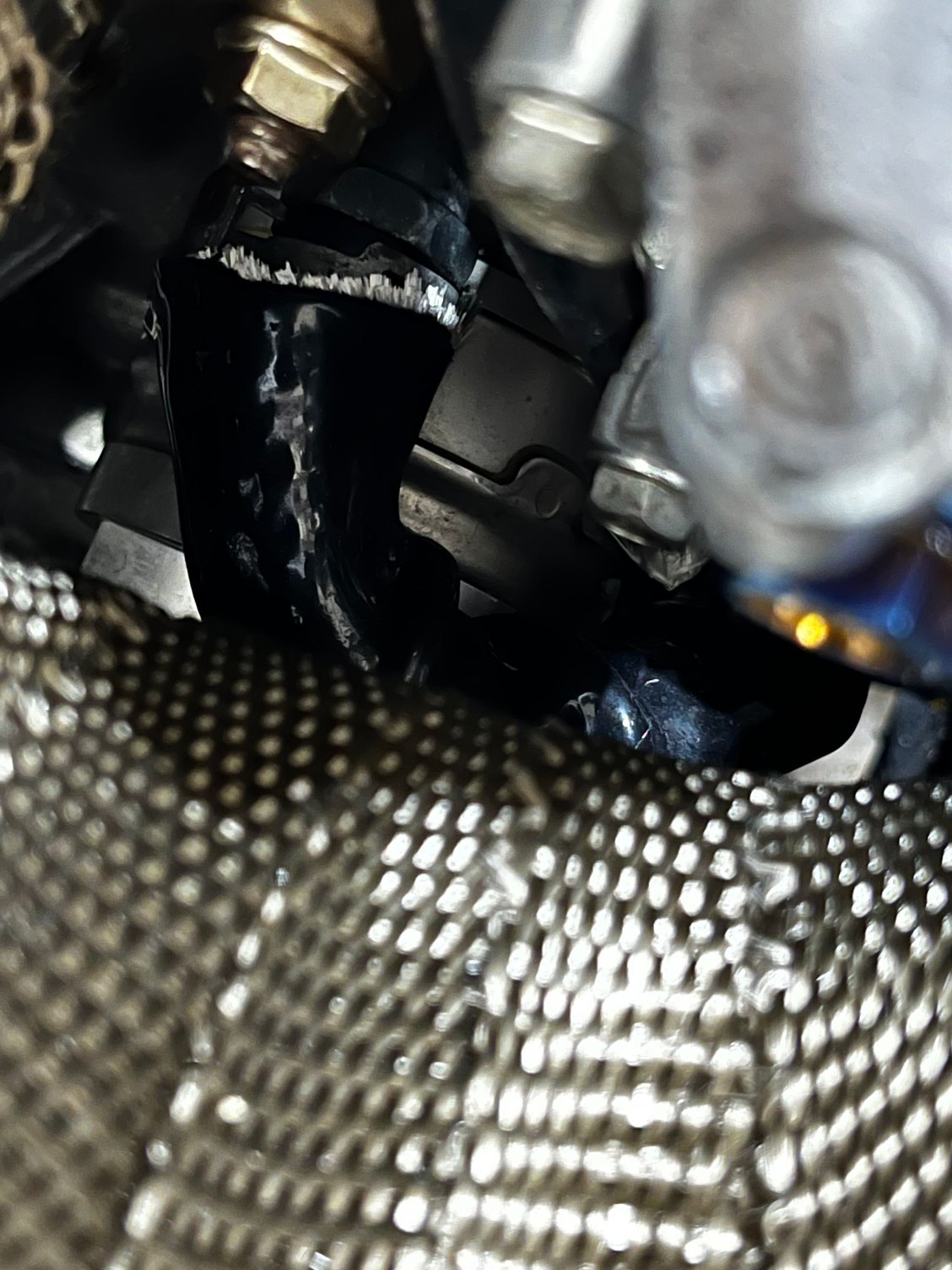

I need help. Ive melted my Vtech oil psi switch one too many times. I want to delete and bypass the wiring or whatever. Cant seem to get any solid info. Need help plz

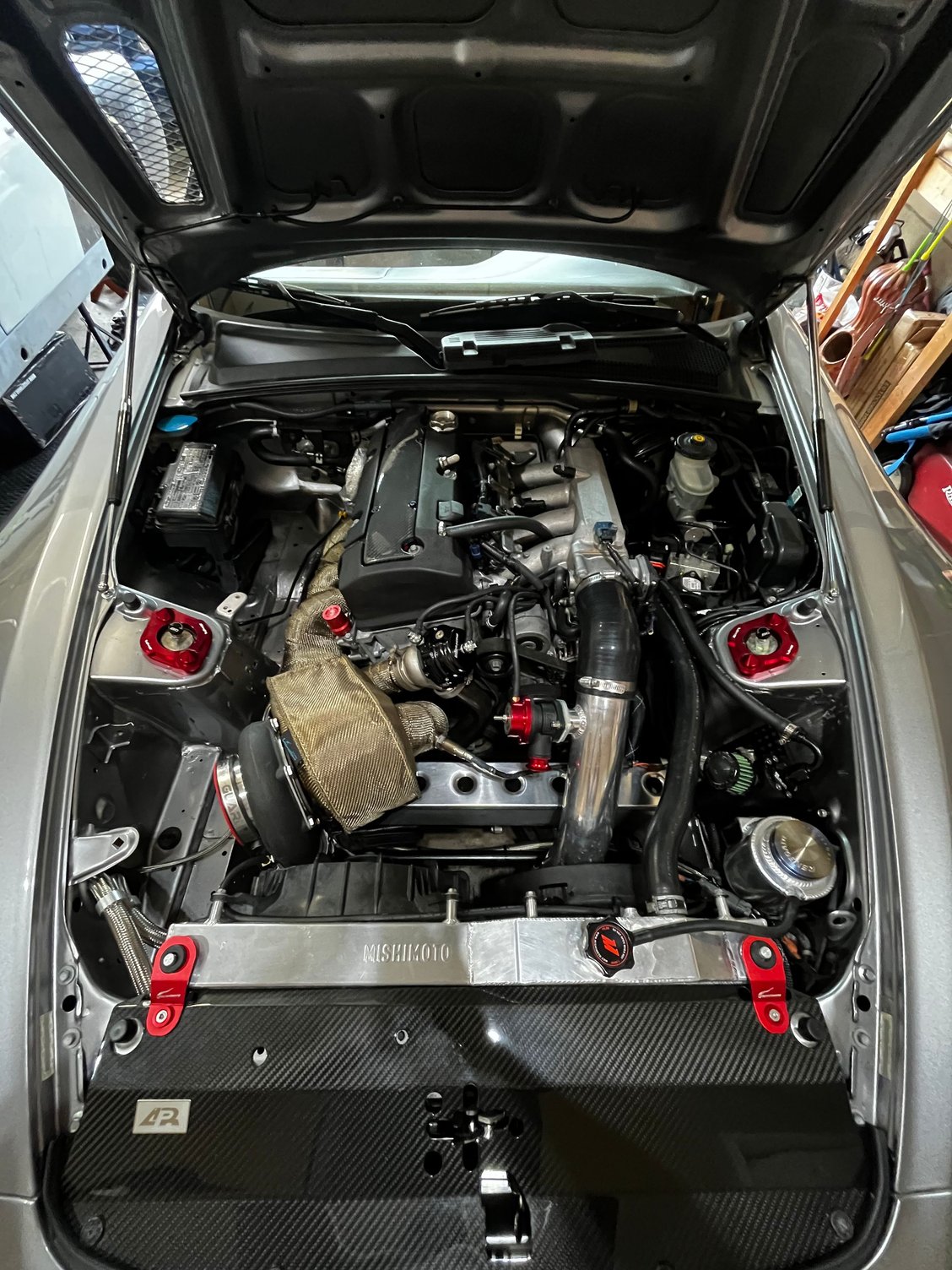

I understand. Your engine bay looks awesome and nearly 600 wheel HP is pretty intoxicating. What engine management are you running ? Almost all that I can think of offer the ability to turn off, and thus delete, the VTEC Oil Pressure Switch in the calibration. Doing this, you could then remove the oil pressure switch and never have to worry about it again. RyWire offers a Titanium bolt that seals the threaded hole in place of the oil pressure switch for cheap... like $12.

Titanium/stainless heat shield and some thermal sleeve on the harness large enough to slip over the plug?

Well I've sleeved it too. No way to get a heat shield of just the switch. My header pipe to close. Tks tho.

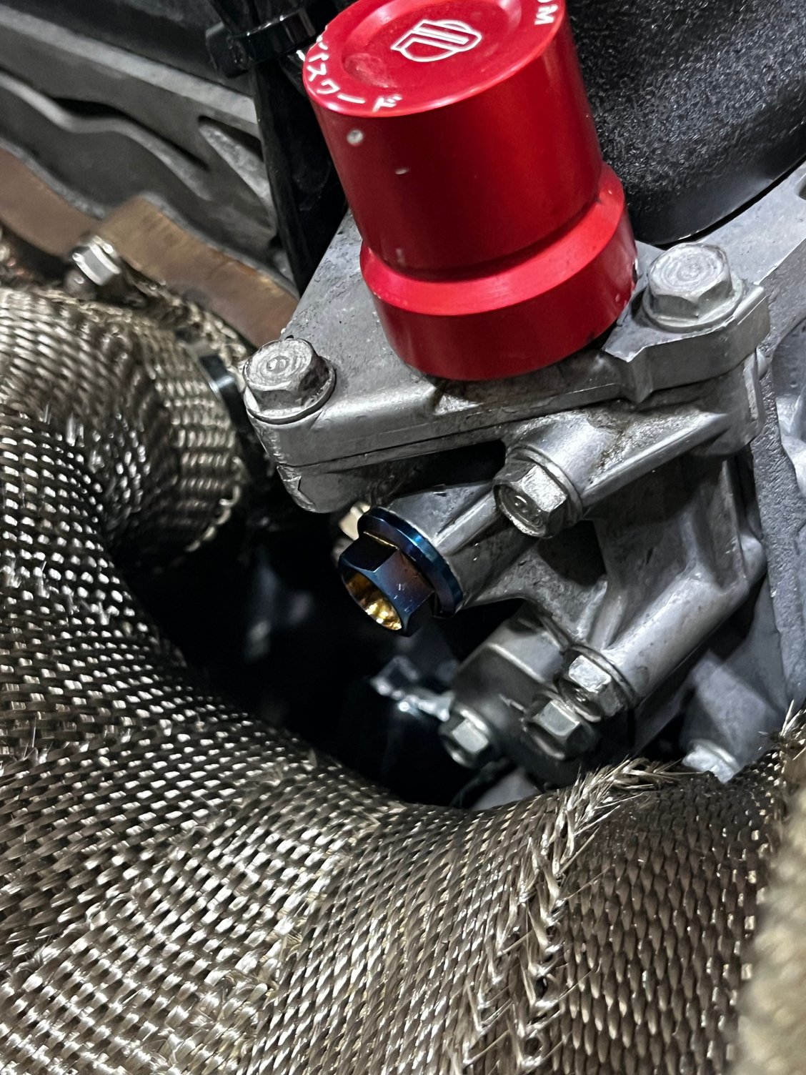

Old Jul 8, 2024 | 05:57 AM
JimyJakJr's Avatar
Joined: Jul 2024
Posts: 6
Default Re: My S2KAP2
Here is the bolt
Also insulated my cooler hoses. And ive used this same sleeve to cover the switch.
