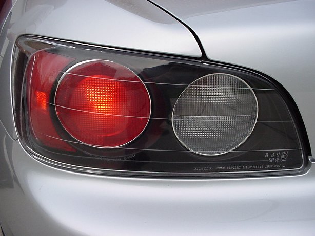

there are some little changes as the years go up, i know for sure my 00 radio has no clock, but the 03 does. there are also, on the door panel for the 03 they have little tiny tweeters or speakers(not really sure what there called. the tail lights of the 03 has a chrome ring around one of the circles. i think the 03 headlights, have more chrome in the headlights, but it still has black housing, im not sure if the problem in the noise for the tranny i think thats what im hearing in my 00, but for the 03, some if not most problems have been fixed. my suggestion is get a new model. i got my 00 cuz i got a deal with the hardtop, but from IMHO you should stick with newer years, the 99-00 is kinda like to just get the car out there, for the 02-03 more of the problems that were mention got fixed if there were any, hope this helps, this is from what ive been reading, im sure somone could correct me if any are wrong.

• A chrome ring has been added to the tail-lights.

00-01 tails
2002 tails with chrome rings added
