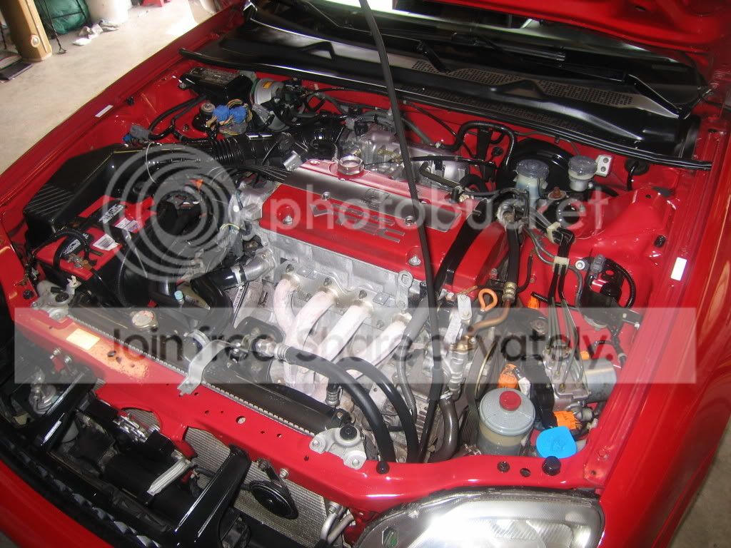

i put a plastic bag around the alternator, distributor, and battery. Then hose the engine bay down with ORANGE BRIGHT ENGINE CLEANER. then after letting it sit, spray down engine with water hose. Remove plastic bags. use NO TOUCH tire cleaner spray to get a really even clean shine on all your hoses and black plastic. close the hood, let the engine run for 5 mins and you get something like this:
bought both products at autozone or advance i think
