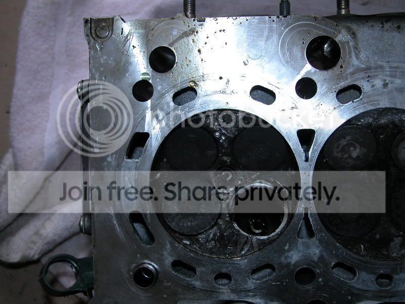

How the hell do i get the head off. I have a bolt somewhere under the intake manifold holding the head from coming off ...... I cant see it ,... HELP A.S.A.P.

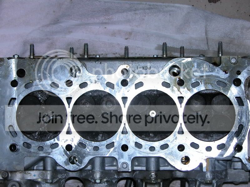

Sending block to ERL , is the head salvagable???

Maybe it's salvageable if you have all the domes resufaced to the same compression otherwise the head is pretty screwed.

I doubt you can save the head. I think I see pieces of the valve seat missing, along with deep pock marks from the valve, which means you'd probably have to weld in some filler. Still gotta worry about stress cracks, milling the head for a flat gasket surface. Good luck.

thanks for the posts, i just picked up a new head, what would u recommend me to do with the head jw

that would be one hell of a head job to redo that head, imo its not worth it, buy a used head, put aftermarket springs in, cams etc.

Im going to have to agree, take out what you can then throw the head casting in the garbage or take it to a scrap yard and try to get some dollars for the metal.

i saw a guy selling a head on here somewhere. I suggest you buy it. The cost of repaing and then the headache of knowing "what If" will make me buy a new/used one.

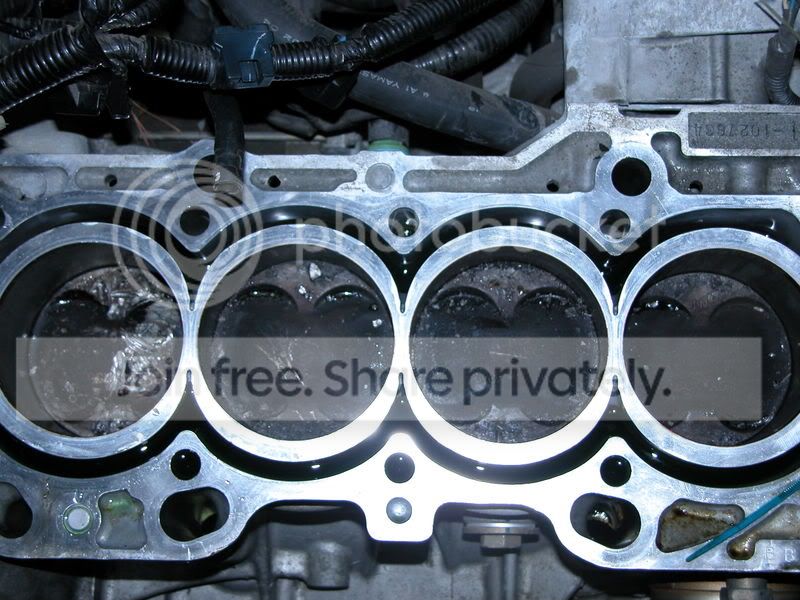

damn man..........those are some beefy *** sleeves.
