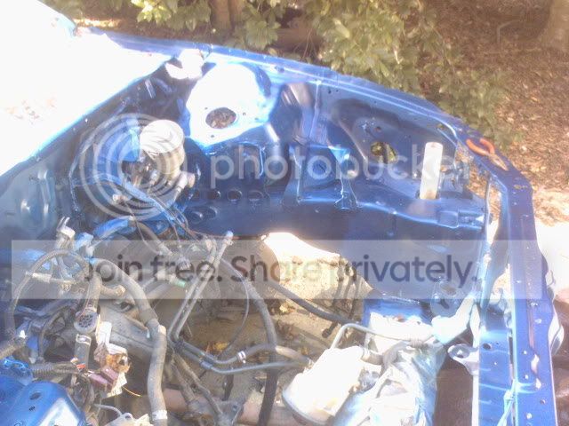

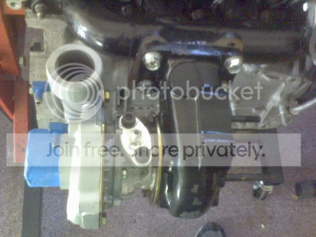

Hey guys finally feel like i am make a progress on my 2.5 month turbo install.. I have been really busy with some engineering class at college and then work is trying to work me like a borrowed mule but check what i have got done and tell me what you think.
Here is the car last year, 1 yr after owning it

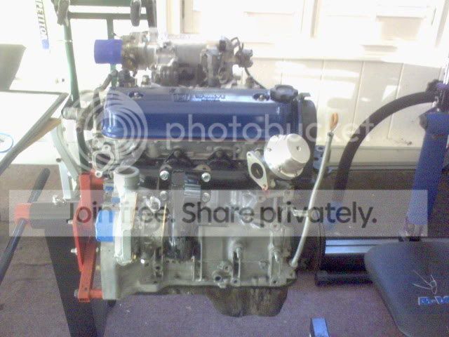

engine build
my twwwurbo

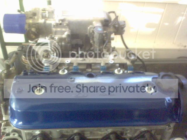

I painted my valve cover the same color as my new engine bay color

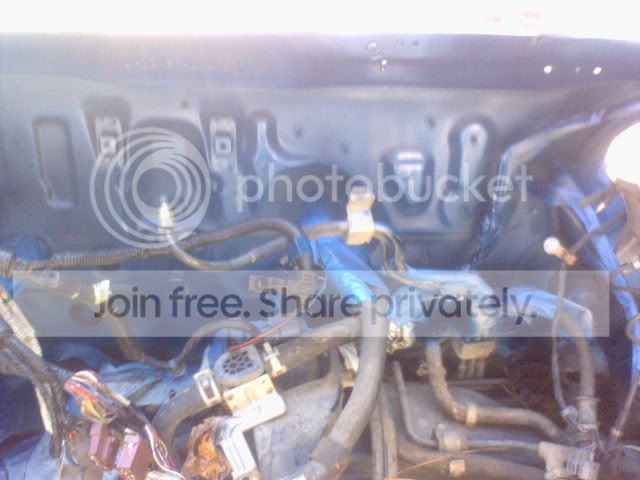

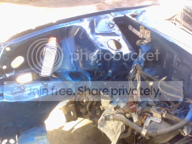

Engine Bay
thanks,
Thomas

Good work so far
What's the rest of your setup?

Setup
Custom log mani
garrett airreseach t3 .63ar .58 trim turbo
intercooler (fmic) and piping
turbo xs-h-rfl bov
tial 38mm wastegate
voodoo boost controller
walbro 255lph
dsm 450cc injectors
hondata s200 with chipped p75
exedy stage 1
head work:
...valve job-3 angle, resurfaced, valve guides.
not upgrades, but new
head gasket
valve cover set
intake mani set
oil pan
timing belt
water pump
there is proably tons of stuff i have left off.....boost is not cheap at all and I will vouch for that anyday. It seems like i just continue to spend spend spend

um....on the horsepower gains, i dont really want to say anything that sounds crazy or stupid. But when I first started I was looking for the 200 mark, but the more I have researched there are people make more with the dsm setup with less mods and cheap setups. I will be satisfied for anything above 200, but looking for the 230-250 mark...
It is a general consensus that the f22a1 will make handle boost great, and there are many people that drive around boosting 10psi all day long for years. Quite a bit of these are running the dsm setup. Im not going to solely base it off of a psi number b/c every turbo displaces differnt at psi numbers. I have a rather big t3 so my lag will be a little longer, but hoping to be under full boost at 3600-3900rpm... The dsm brings it in a little sooner thus running out of air in the upper in.
Really in all honesty it is the torque gains that I am looking for. I do not have any numbers, but Im expected a very wild torque band. I have spent some time on the phone with a respected tuner and he says he has tuned 2 f22s. One of those being boosted and the other was a na setup....He said that the torque gains was phenomial. Anyways Im getting kinda close to finishing, and Im sure I will find something else to ask everyone before the big tune day, if not numbers will be posted :D......
Oh yeah, the color I chose to paint the bay *which will also be the color of the exterior when i get a chance to paint it*... It is called Intense Blue it came of a dodge vehicle and only one of dodges carries it from the tag which leads me to believe it is dodge viper blue....Very pretty color with blue pearl and some metallic in it.
