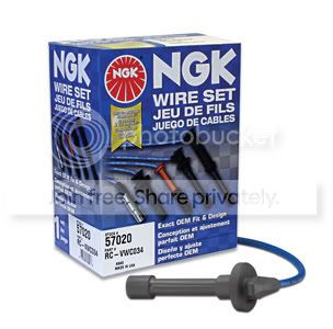

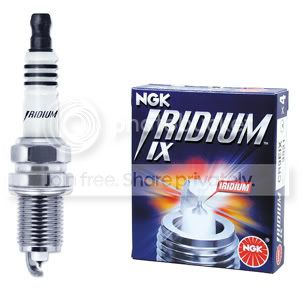

so if i run
with
.044 will be what i need
