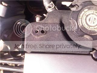

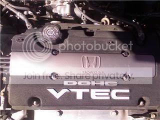

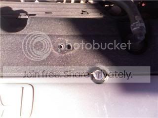

Well there are these spots on the head that look like there was some type of bolts or screws in them. i have never noticed them befor whitch leads me to belive there was something in there and now there is not.
here are some pics
Any info will help thanks

Im not 100 Percent sure, but I think they are fine left alone.

I've never seen anything in those holes on any of the preludes I've looked at. they are empty on my car too. maybe they are for something on a jdm or European model.

I think it may be a vent of some sort on the head

i believe it is for an automatic transmissioned car but i am not positive.

It's not on the auto trans either, just looked. The threads in the holes are oxidized so it looks as if nothing has ever been installed. Who knows.

thouse holes are for JDM cars their cruise control line goes in thouse holes and holds it down

never mind its for throtle body just went outside and took some pics

Those holes are for the throttle cable bracket on RHD Preludes

ok so the holes are supposed to be there cus im not RHD right?

indeed it is. Mines RHD and my throttle cable was bolted to these. I removed them and tucked the throttle cable under the injector harness. Looks so much cleaner.
