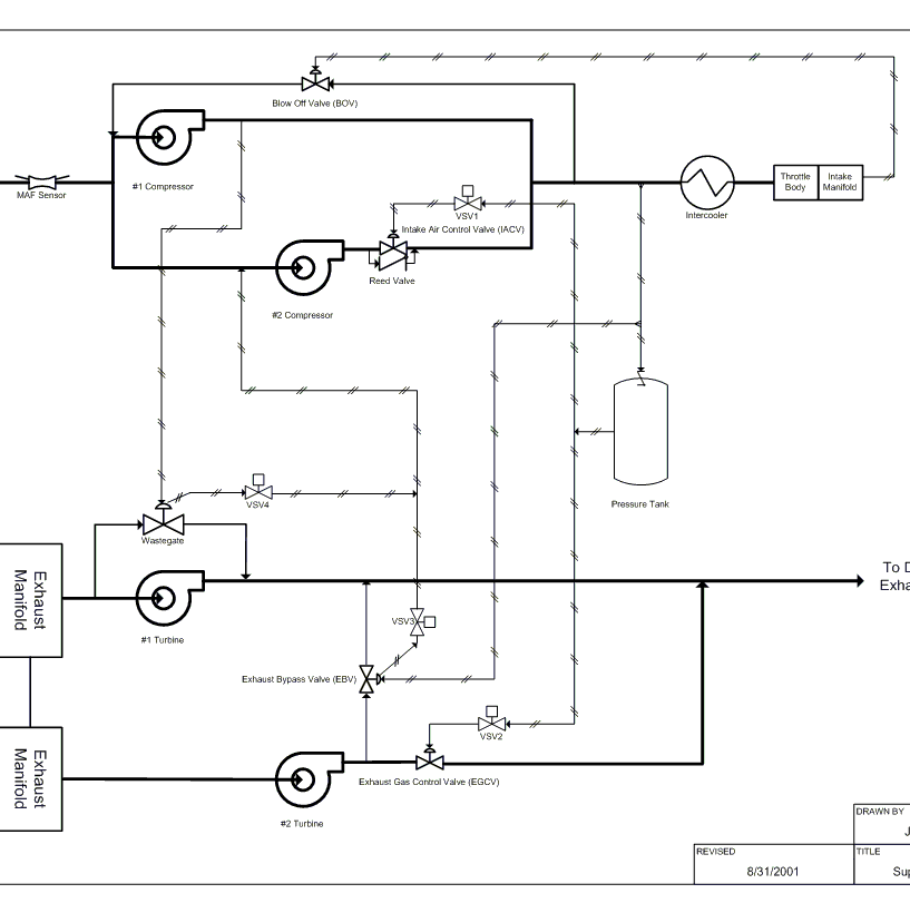

okay prelittlelude, you have a supportive statement and i'm not flaming, just curious as to how the "sizing" really works? I wouldn't imagine that the h22 has enough shear exhaust flow to push that kind of setup. Interesting concept.
As far as cost vs. benefit, you probably have c-notes to wipe your *** with if you think its worth the money.
edit:: adding some questions:
Given this image, i would imagine the problems/difficulties would be:
_Manifold/turbo mounting space (or lack thereof)
_Controlling the multitude of valves (piggy back unit for ecu? hondata?)
_Pressure tank (or is that the vacuum control unit that we already have?)

What, no thanks to me for the image?! jp. I've seen some people go the JRSC + Turbo but i think it was a drag only application. Keep up with the research and definitely go for it.

Sorry big guy. THis is for you,

<TABLE WIDTH="90%" CELLSPACING=0 CELLPADDING=0 ALIGN=CENTER><TR><TD>Quote, originally posted by optikal_blitz &raquo;</TD></TR><TR><TD CLASS="quote">okay prelittlelude, you have a supportive statement and i'm not flaming, just curious as to how the "sizing" really works? I wouldn't imagine that the h22 has enough shear exhaust flow to push that kind of setup. Interesting concept.
Modified by optikal_blitz at 1:10 PM 5/16/2005</TD></TR></TABLE>
Where did you find this pic?
Old May 19, 2005 | 08:28 AM
optikal_blitz's Avatar
Joined: Mar 2002
Posts: 3,262
From: Rochster, NY, Grubby Nettles
Er..forgot to give credit to the site but:
http://www.lextreme.com/sqtt.html

How would this work? What if you had a small turbo blow into a larger turbo so the larger turbo could spool quicker? How would that work? I would think the large turbo would spool almost as fast as the smaller turbo then. Let me know what you all think?
Old May 19, 2005 | 03:33 PM
Joined: Mar 2002
Posts: 3,262
if you read through the article, there is actually a valve that controls how much the exit gas pushes the larger turbine to spool it. It's RPM dependant so at low revs the valve is closed, thusly not spooling the larger snail.

<TABLE WIDTH="90%" CELLSPACING=0 CELLPADDING=0 ALIGN=CENTER><TR><TD>Quote, originally posted by optikal_blitz &raquo;</TD></TR><TR><TD CLASS="quote">if you read through the article, there is actually a valve that controls how much the exit gas pushes the larger turbine to spool it. It's RPM dependant so at low revs the valve is closed, thusly not spooling the larger snail.</TD></TR></TABLE>
Yes I read through the artical. That is where I got this idea from. I am not talking about using the snail for any horsepower at all. I am only talking about using the snail to spool up the larger turbo. This way no valve would be needed. Smewhat simpler for us tuners.

I see what you mean about using the small turbine to spool a larger one. It could work.
