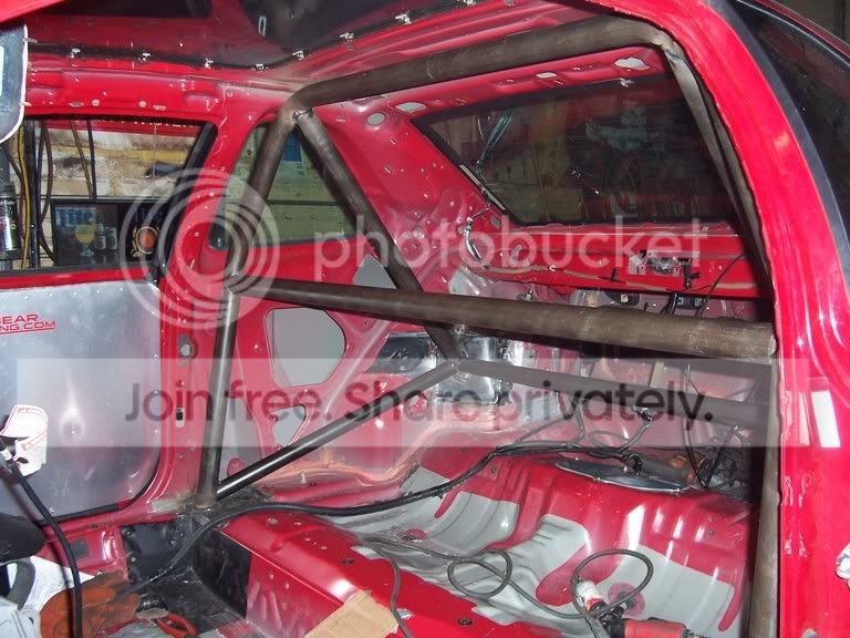

Full cage 1 3/4 .095 wall mild steel.

Is it going to be a full cage? Is the cage needed or just doing it to do it?

required for his class of road racing

Oh ok. 1/4 mile guy here. What point is the cage? 8? 10?

road racing cages are usu spec'd as 6 pt.

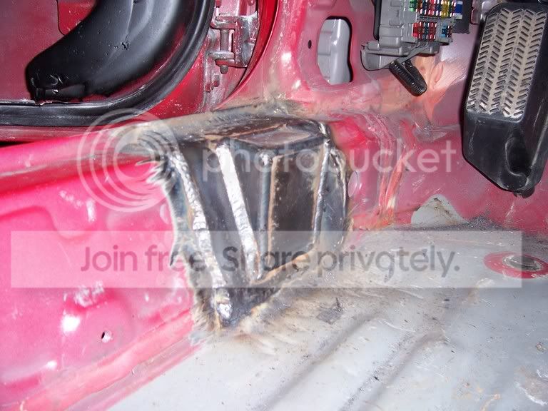

Looks good man.. Welds look good from here too.

though looking at the middle cross there's no recession--is there going to be enough room for a seat and a harness setup? also are you gonna have a main diagonal from top left to bottom right?

<TABLE WIDTH="90%" CELLSPACING=0 CELLPADDING=0 ALIGN=CENTER><TR><TD>Quote, originally posted by bad-monkey &raquo;</TD></TR><TR><TD CLASS="quote">though looking at the middle cross there's no recession--is there going to be enough room for a seat and a harness setup? also are you gonna have a main diagonal from top left to bottom right?
I'll show you toinght

that would be my car
It is getting the cage to be legal in NASA and SCCA road racing. I'm moving from trime trials up to full wheel to wheel, door to door, fight for the finish line road racing this year.
As for the diagonal brace in the main hoop, that is going in today, and it will be 1 solid strait bar. The guys are Domination Chassis have that seat belt bar marked were they need to cut part of it out for the diagonal brace. Don't worry it will be a legal 6 point cage before it leaves their shop
I'm loving the pics can't wait to see more tonight
and in person tomorrow afternoon.

is it hard to install a roll cage? my dad is an experienced welder, but doesnt weld cars or anything, and i was wondering if we could do it.

Just a question, but is 1.75 x 0.095 legal? I haven't checked the GCR or CCR lately.
Here's my HC legal cage to show a little comparison. You can see there are definitely some things that Walter is doing differently. One way isn't necessarily better than the other, just different.
As for the sunroof plug, for SCCA, it needs to be the same material as the stock roof. For NASA, it can be composite.
I recently replaced the Sparco with an Ultrashield seat, much better fit than the Sparco!
Looks good Walter!

Here is the general design of the cage that Domination is building for me, with notes about rules.
from the NASA CCR:
<TABLE WIDTH="90%" CELLSPACING=0 CELLPADDING=0 ALIGN=CENTER><TR><TD>Quote &raquo;</TD></TR><TR><TD CLASS="quote">
<U>2201 - 3000 lbs (car weight)</U>
1.5" x 0.12" chrome-moly / seamless mild steel (DOM)
1.75"x0.095" chrome-moly / seamless mild steel (DOM)
The 1.75x0.095 is lighter per foot, thus why we are using it.
