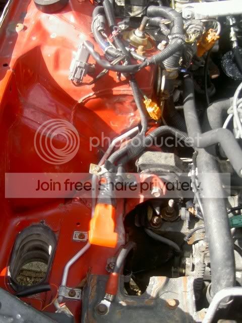

What i meant when i referred to the postive terminal, I was actually talking about the wires that come from the starter and the fuse box.
I can see what u did w/ the wire from the fuse box hawke Im assuming the wire from the starter went the same direction too?

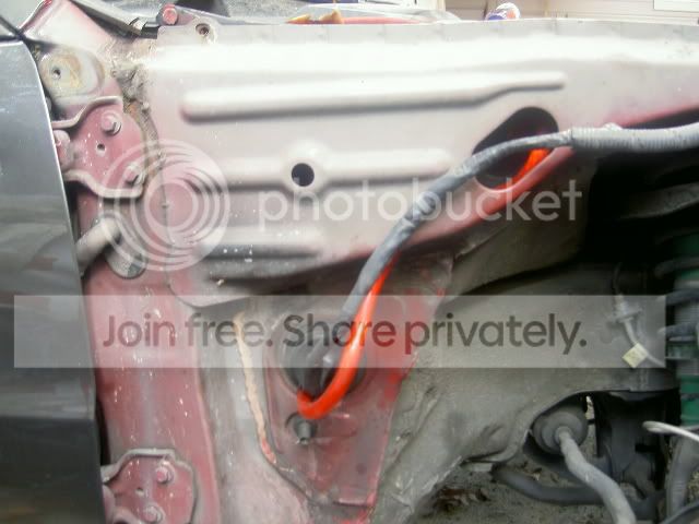

here where my batter/starter/fuse box wires are.
this is the route i chose.
saikou what specific type of block did u use?
