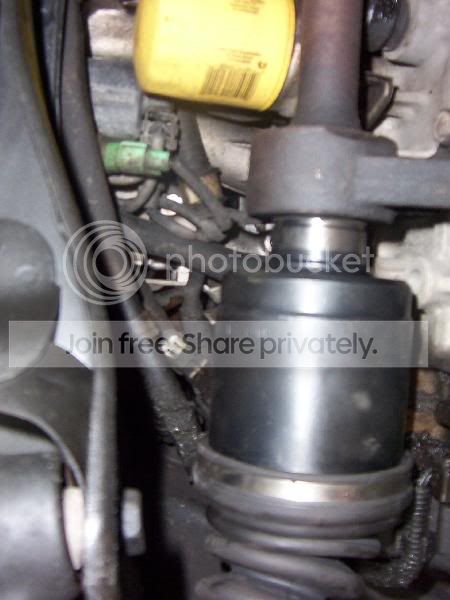

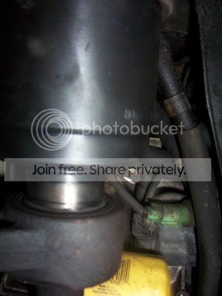

Here are some pictures of the Passenger side. Which Im sure is in all the way.

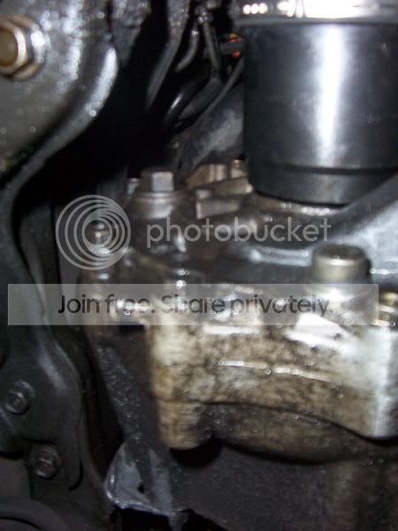

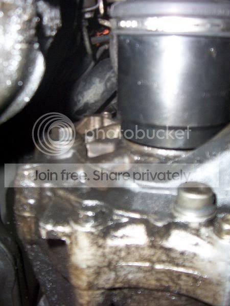

Now Here is the driver side, which I'm not sure about.
SOmeone please help.
Old Oct 16, 2007 | 11:21 AM
arkosh.kovash's Avatar
* B A N N E D *
Posts: 393
From: ATL
Default Re: Problem after installing Axle(Driver side) (jackmode9316)
Chances are it is the axle. If it wasn't happening before the axles were replaced and now it is, the change (new axle) is probably the culprit. Not saying that this IS the problem, but....

Okay! Thanks, so from what you can tell the axles are in all the way?
