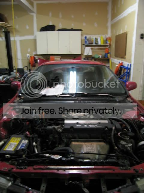

Well some of you might have seen my motor I got about 2 weeks ago that had the head full of gunk/old oil. Well I got a new motor from them and finally finished the swap this past weekend and got it running first try. I've finally got the kinks figured out (clutch bled, I welded a new downpipe to match the h22a header and all the vac lines hooked up). Everything is great and runs perfect.
My only problem is that when I sit at idle and turn the wheel left and right, the steering wheel seems to vibrate. I checked my power steerting fluid and its topped off and the belt isn't loose (there's some slack, but maybe its on too tight?). When I drive around it the rpm's are above idle, the problem is gone. I didnt open the ps lines at all, so I'm not sure if/how air got in. Anyone have any suggestions/advice? I already searched, but I really couldn't find anything like my problem.
Thanks
here's a pic of my car in my garage right after finishing the swap
