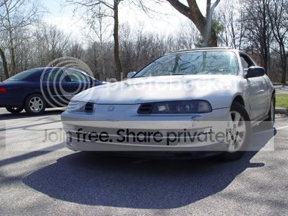

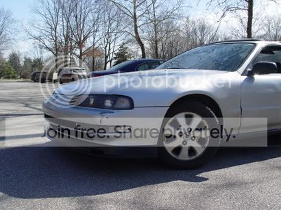

All I did was take off my front bumper and unscrew the OEM lip on my Prelude. After that I just turned it upside down and put the Mugan style lip and held it in place while my cousin just drilled holes directly to where the OEM lip was placed. I have to say though, fitment is not perfect, lets just say that it fits, but will stick out in a few odd spots. I've heard the Type-R style lip is about an inch or so longer on both sides. I have not tried the lip, I have just read a few reviews on that lip so I don't really know and won't say. Though my lip just has 6 screws drilled into the placement of the OEM lip. It doesn't have any play at all and I really like the look of it on my Prelude.
