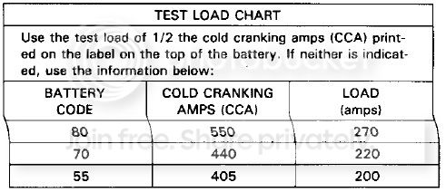

the battery in my car is 720 cca it was in there when i bought it im gunna check the helms for oem cca

m2b4: why in the chart does it have 3 choices? one for each model prelude?

in the chart theres 3 diff ones b/c it said if you cant read the info on your battery it gave the oem 3. when testing your supposed to read a code (if the stickers were un readable or gone) on your battery when you test it so you knwo how many cca it should be. my natural guess would be 3 for each diff model. i checked the odyssey website and couldnt find any for cars lower then 680. if someone can link me. the braille one has 425cca but i dunno if that would be enuf. right now i have a silvercraft and it weight 46 lbs i wanna drop that weight
