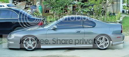

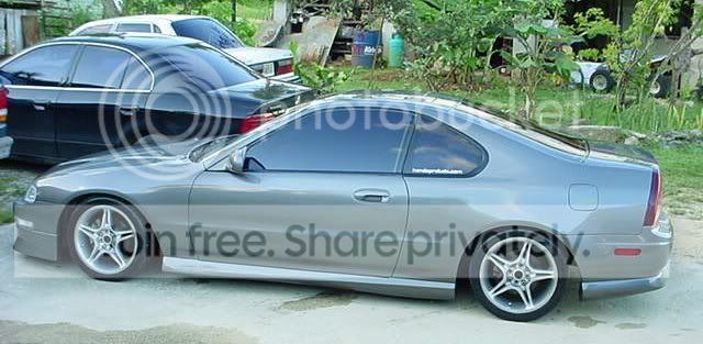

205/40/16
insane drop
pics are 3.5 years old
i sure miss those rims tho
