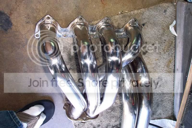

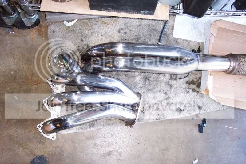

ok got it!
these are the pics before i picked it up.
can't wait 'til i finish my swap n bolt this thing on.

CONGRATS! Looking spiffy . Can u measure and post the primaries, secondaries, and collector sizes? Thanks

looks dang nice bro.

Looks like it's in good condition, I'll bet you're the only one even in California with that header, so good job on the unique department.
Since you can't put it on yet, are you going to buff the manifold all blingy like?

nice find!
p.s. why are you wearing socks with sandals!!!! argh!

95greenlude, im not the one on the pics. i dont even own a pair of sandals.
VTECnKEN, it's pretty much 90% polished already. so i'll probably just leave it like that.

DUDE !! OMG! I am pretty damn sure that the jun header was only made for the h22! THIS WOULD SO SUCK! If this case is true....i am so willing to take that header off your hands!
...I think I have some bad news. Check out this link and look at the bottom...Only h22

cause if it fits......you got a fake header. if it doesn't, well you didn't do your homework.
h23's get no great headers unless you get a custom one

I've read that RSR*= JUN, that they are the same in all measurements and materials used, just a different badge welded on.
EDIT: I've also read that the primaries and secondaries are the same size as the Greddy's, only difference between them being the collector diameter. Even if thats the case, 2.5 inch collector modded greddy's have been shown to make really good power

That thing looks pretty similar to the greddy header, just with a bigger collector...
let us know all sizes or course
nice find

yep, I posted dynos of the Jun haeder vs a Prospeed header. The Prospeed had better top end but the jun made the car faster with the better midrange. The Jun collector is 60mm. It is an RSR. Same as Greddy with larger collector. Nearly identical to a Mugen.
