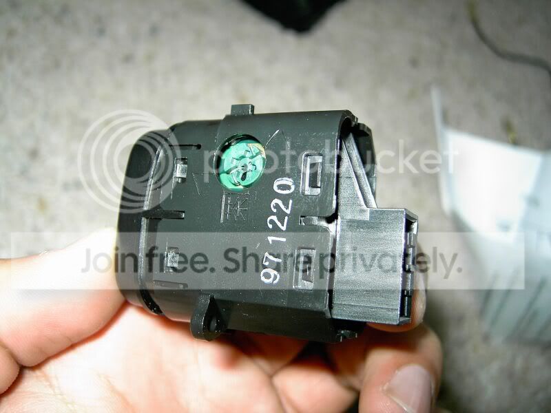

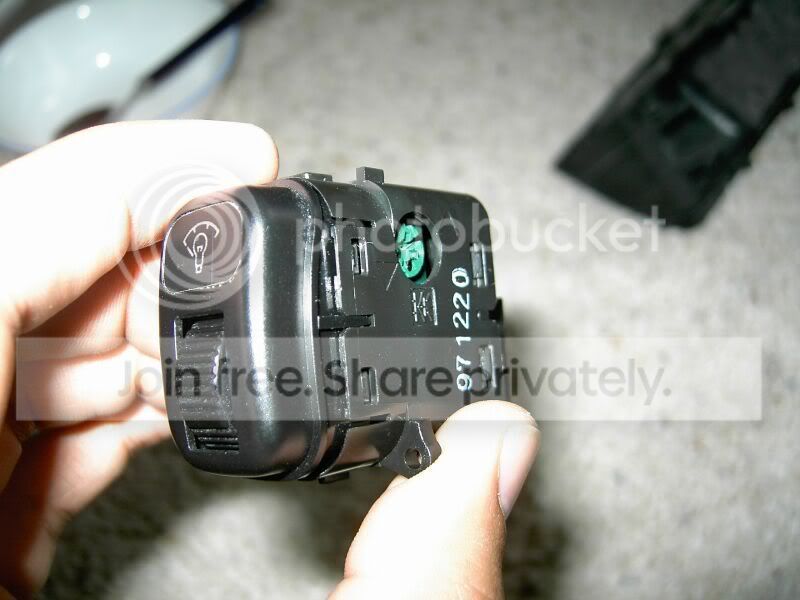

how to diassemble this switch
Old Sep 10, 2006 | 11:05 AM
hamadiscool's Avatar
Posts: 724
Default how to diassemble this switch
So i just want to open this damn thing up...any help will be appreaited
Old Sep 10, 2006 | 12:34 PM
kulrevon's Avatar
Posts: 1,679
From: westchester or philly, ny
Default Re: how to diassemble this switch (hamadiscool)
Why do you want to take it apart?
The green thing is a lightbulb rotate it with a screw driver and take it out.
I believe both sides pull out. the top goes up the bottom goes down. just pry the clips enough to get past the tabs. but the are very delicate so do not bend them too far they will break.
