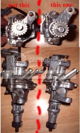

are all of the VSS(hehicle speed sensor) of a h22 tanny the same??? will a 97-00 tranny vss fit a 92-95 tanny vss?? thanks in advance

i think they are all the same. i have a vss from an h22 in my h23 trans.

No there are 2 different versions. Let me see if I can find the pic i have of both...Stay tuned

Both of these came off of preludes....h23 and h22. I ran in to this problem 2 or three this over the years. If they look the same then it will work but make sure its the same. for some reason there are a few out there with a different mounting 'tab'

yeah they are different

im using one from a 94 accord

ya thats odd. im currently using one from an h22 was using one from an accord before i accidently broke it. maybe its just different with certain trans.
