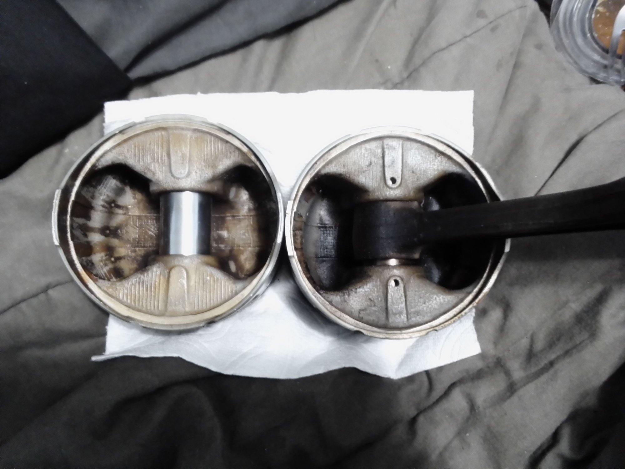

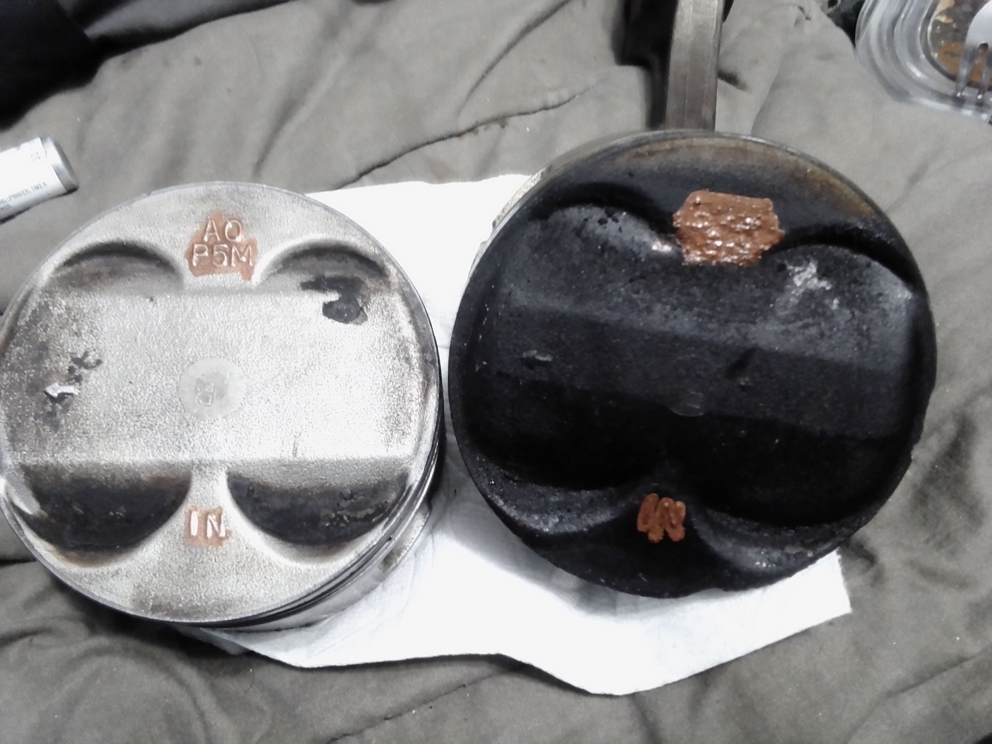

I have had and gone thru 5 different H22's various years USDM/JDM Si, Type S vtec, Type SH, EURO-R OBD1 OBD2a/b P13, P5M, P5P, PCD open and closed decks and every single one of them consumed oil, smoked, gradually lost power. The most common thing i found in comparing is all four pistons cracked out ringlands between 1 and 2 and only on the intake side and all rings were stuck in piston the heads lost compression due to carbon build up at exhaust valves that somehow scared or warped the seats cuz light shine or even leak test showed multiple areas dripped. Ive noticed each pistons shapes were different some had taller domes some were almost dished. The older H22's connecting rods didnt have circlips and were shotpeen pressed in, the newer H22's were circlip floating wrist pins. Mid 97 production H22A4's were upgraded with beefier cranks having 55mm mains compared to 50mm mains of prior. The piston bottoms under the skirts had drilled holes on some while others didn't, i think it has to do with oiling for wrist pins. Another major problem i found is the rear balancer shaft cog seal gets worn or blown out and its almost impossible to replace just the seal it may require pressing out the cog from the inner shaft and gear to actually get to it. But no one sells that seal, this is probably why alot of guys went with the delete kits. 2 of 5 of my H blocks had vertical hairline cracking in cylinders from top down one was a closed deck and in #3 cylinder the other was open deck and in #2 cylinder. All my motors were N/A however i recently found out one of my older H22A was briefly turboed by previous owner that never mentioned it. But the fact the motor failed 2yrs later and one of the conrod bearings looked extremely squished made more sense after finding that out. Anyways I got some pics of everything I mentioned. Just not sure if it will allow me to post it here.
Differences of H22A1 and H22A4 pistons and rods: Wrist pin sizing, circlip, stampings, dome heights

Found in common Cracked ringlands in same area between 1 and 2 and on intake side only noticed skirts a little longer on the left one(H22A4) right one with conrod is H22A.
Drilled holes at wristpin area underside of pistons
Piston tops stamped P5M and P13 different shaped domes as well as height

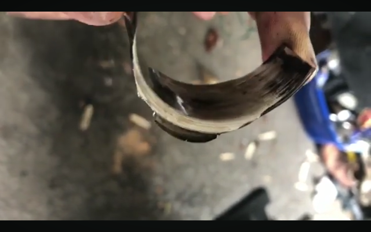

Extremely Squished out rod bearing H22A
