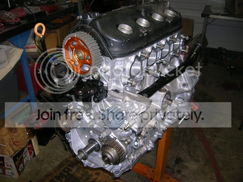

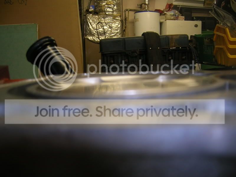

Old Mar 3, 2008 | 03:12 PM
amalby's Avatar
Joined: Dec 2007
Posts: 90
From: salem, OR, USA
Default Re: F22 Build (amalby)
Heres a pic of the engine mocked up.
one of what I was talking about
one with the head off
Ill up date with more pictures tonight once the head goes on. Ill also be checking TDC and piston to valve clearance also. let yeah know
Old Mar 3, 2008 | 03:15 PM

how much material was removed from the deck of the block?

It doesn't look like they come out of the head very much. If your head gasket gives you enough clearance so that they won't touch the head, they you should be fine.

.020 thousands was taken off the block.
<TABLE WIDTH="90%" CELLSPACING=0 CELLPADDING=0 ALIGN=CENTER><TR><TD>Quote, originally posted by flyrod &raquo;</TD></TR><TR><TD CLASS="quote">It doesn't look like they come out of the head very much. If your head gasket gives you enough clearance so that they won't touch the head, they you should be fine.</TD></TR></TABLE>
Thats what I was figuring, I bought a stock F23 head gasket from a local auto parts store and it looks like it will be fine (or feels fine.) im going to go test it out in about an hour so ill let you know.
